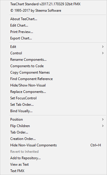

Is it possible to put a watermark on the chart? I tried the background image, but the chart prints above it. I am running version

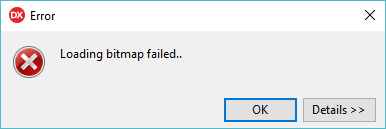

Also, when I try to clear the backimage, I get the following error:
