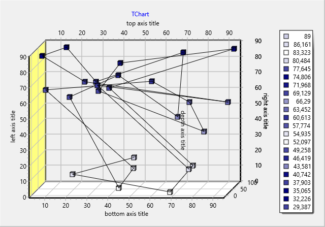

Please try a 3D chart with the DEPTH Axis right. There the Axis Ti is missing.

Post by Narcís » Tue Mar 29, 2016 2:37 pm
Hi Walter,
Depth axis is not visible by default. You need to enable it:
  Series1.FillSampleValues;
  Series1.VertAxis:=aBothVertAxis;
  Series1.HorizAxis:=aBothHorizAxis;
  Chart1.Axes.Bottom.Title.Text:='bottom axis title';
  Chart1.Axes.Top.Title.Text:='top axis title';
  Chart1.Axes.Left.Title.Text:='left axis title';
  Chart1.Axes.Right.Title.Text:='right axis title';
  Chart1.Axes.Depth.Title.Text:='depth axis title';
  Chart1.Axes.Depth.Visible:=True;
The title is rendered at the wrong position though so I have added it to the bug list: http://bugs.teechart.net/show_bug.cgi?id=1482
