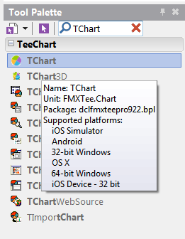

after installation of the latest TeeChart FMX from souces, via the TeeRecompile.exe TChart is diabled for the 64Bit iOS platform.
teeChart disabled for 64Bit iOS platform
Is that done on purpose, because there are problems ?
best regards and thanks
Re: TChart disabled on 64Bit iOS platform
Post by Narcís » Fri Jun 12, 2015 1:29 pm
Hello X-Ray,
If your application targets an iOS 64-bit device, TChart is still available there and builds correctly. You need an iOS 64-bit device to run it though. Did TeeRecompile run fine for iOS 64-bit device? Does this work for you?

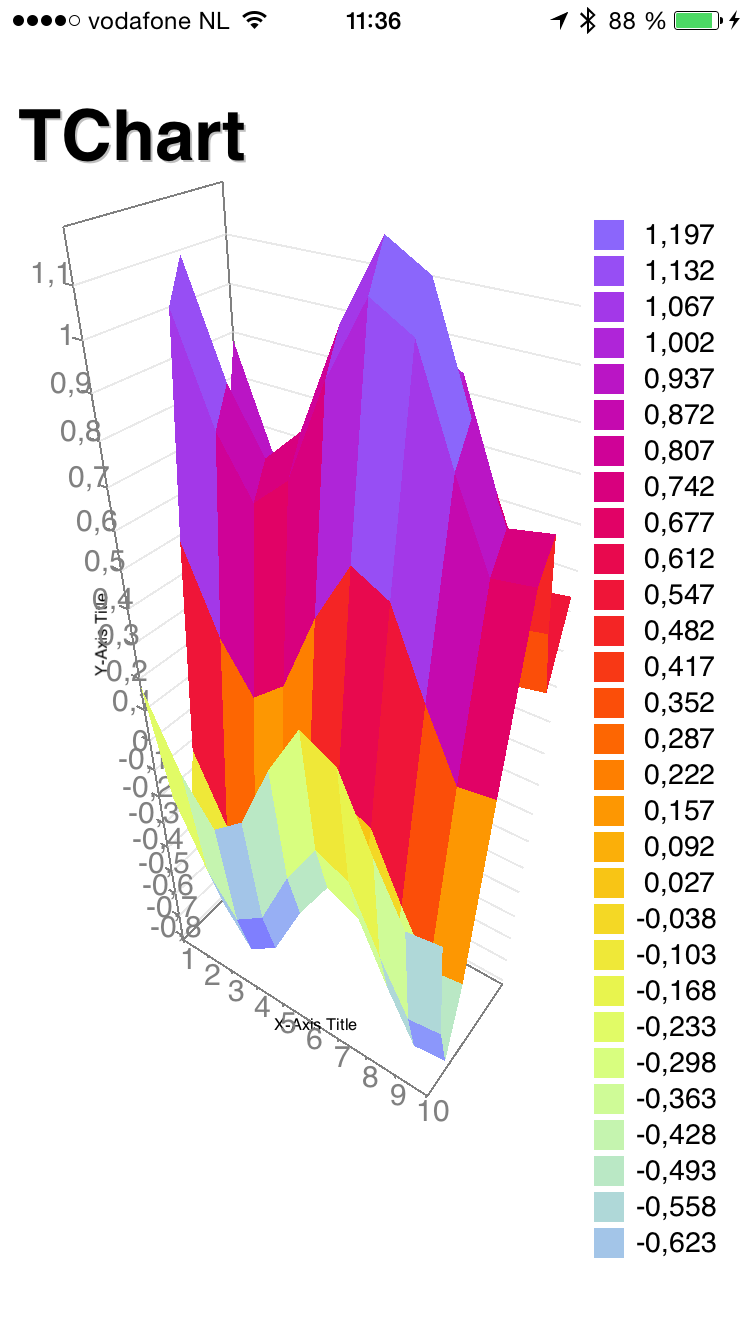

there are problems with axes titles in 3D that got worse with the latest release 2015.16:
Foto 08.09.15 11 36 51.png (131.62 KiB) Viewed 44931 times
I used the gesture example and added titles for the X-Axis (Bottom Axis), Y-Axis (Left Axis) and the Z-Axis (Depth Axis). What you see is (on a iPhone 6):
1) The titles are not aligned with the axis labels (This works well in the VCL version)
2) The distance between the axis labels and the axis title is too short (how can I change this ?)
3) The Z-Axis title has disappeared or is somewhere far away
Are there any fixes for this ?

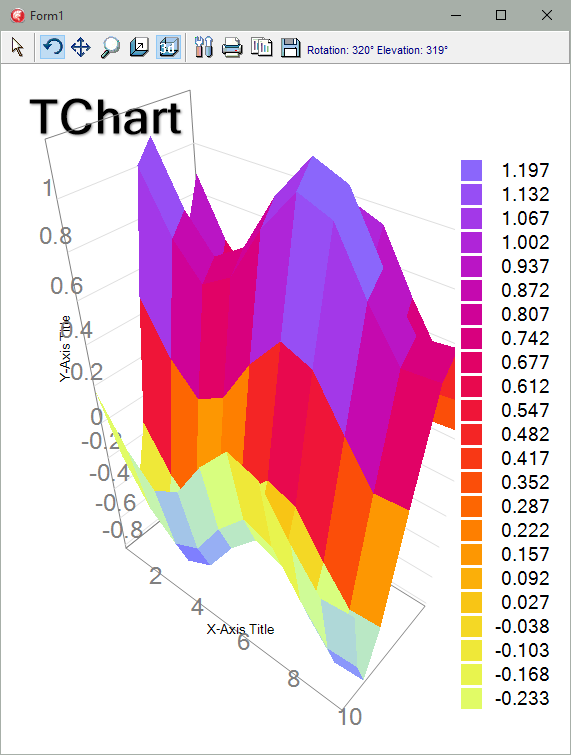

X-Ray wrote:1) The titles are not aligned with the axis labels (This works well in the VCL version)
I get the same result with VCL:
