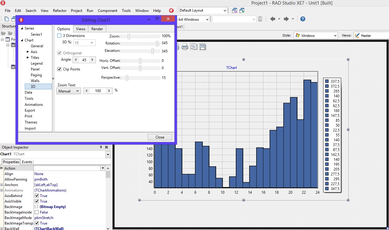

Meantime, I would like suggest some workarounds for the problem you are experiencing.
You can implement and configure properties of TAreaSeries by code to prevent the 3D view problem as do in code below:
{$R *.fmx}
uses FMXTee.Series,  FMXTee.Functions.Stats;
var Series1:TAreaSeries;
  Chart1.View3D := false;
  Series1 := TAreaSeries.Create(Self);
  Chart1.AddSeries(Series1);
  Series1.FillSampleValues(10);
  Series1.Stairs := True;
An alternative is add the TAreaSeries in design time in 3D view in Gallery editor and change the 3D view in 3D editor. The image below shows you how:
Hoping it will help.
