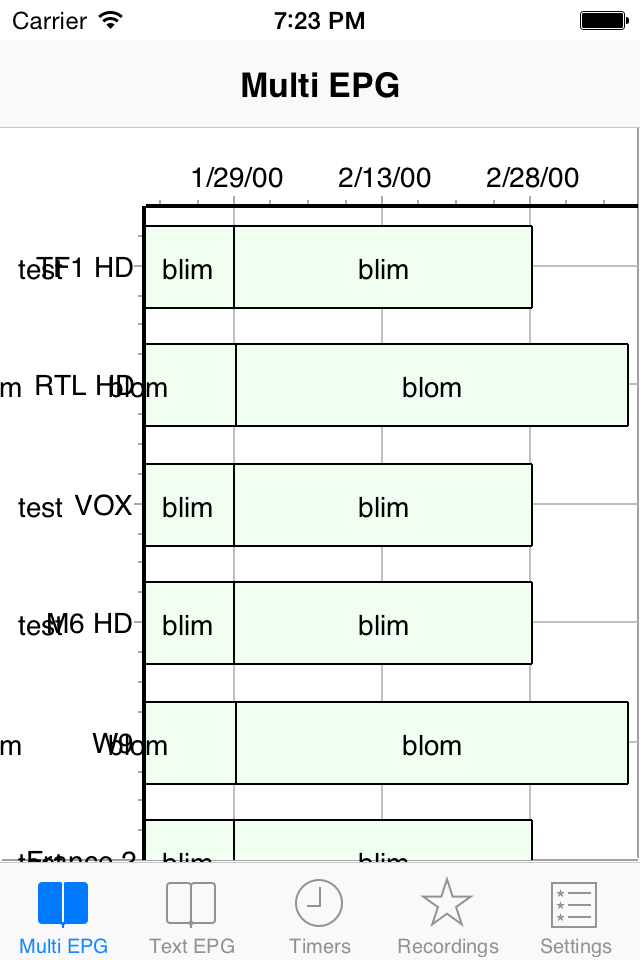

Hi all,
I just noticed that in the latest TeeCharts, the TGanttSeries marks remain visible beyond an axis - can this be changed somehow?
(see attachment).
Cheers
iOS Simulator Screen shot 29 juin 2014 19.23.40.png (50.65 KiB) Viewed 12699 times
Re: Series marks visible beyond axis
Post by Yeray » Mon Jun 30, 2014 1:54 pm
Try with:
Series1.Marks.Clip:=true;
cjacoby78
Posts: 11
Joined: Tue Mar 25, 2014 12:00 am
Post by cjacoby78 » Mon Jun 30, 2014 3:33 pm
Yes!
This did the trick!
Thanks a lot!
