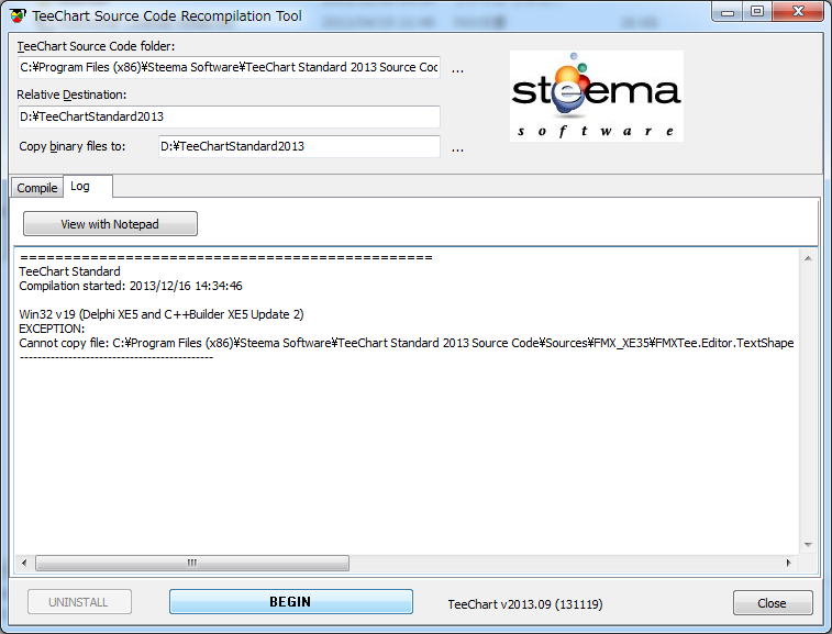

couldn't recompile by TeeRecompile.exe.
file not exist FMXTee.Editor.TextShape.pas.

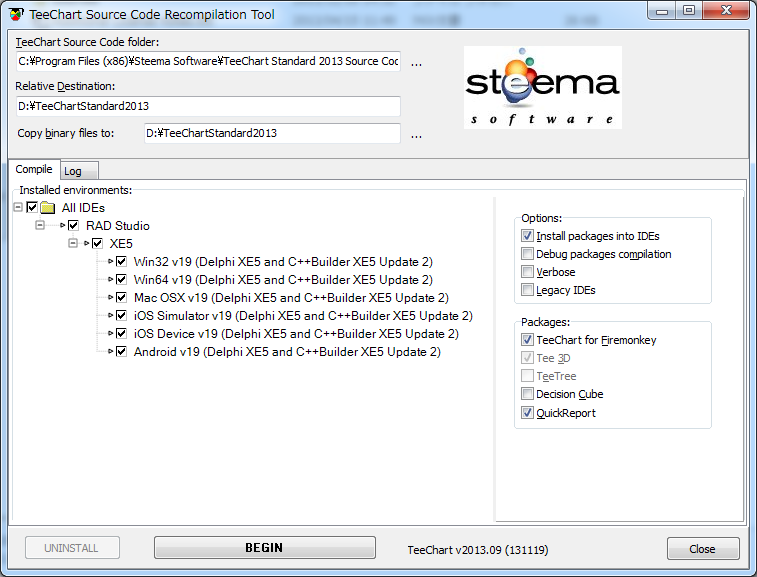

before
after
Re: XE5 TeeRecompile.exe problem
Post by Yeray » Tue Dec 17, 2013 1:03 pm
I could reproduce the problem and we are working on a solution. We'll be back to you here asap.

Please tell me the recommended setting of Recompile.
TeeChart Source Code folder:
C:\Program Files (x86)\Steema Software\TeeChart Standard 2013 Source Code\Sources
Relative destination:
Compiled ??
Copy binary files to:
And Please tell me delphi settings to run in iOS Device.
my environment is
windows7 enterprise 64bit.
Delphi XE5 Update2

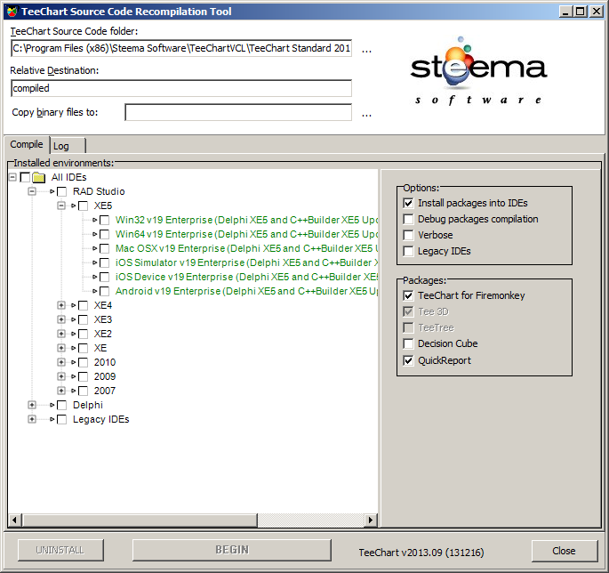

Here it is a snapshot:
makoto wrote:Please tell me the recommended setting of Recompile.
I installed the sources to a slightly modified path because I have many TeeChart installations I want to keep:
C:\Program Files (x86)\Steema Software\TeeChartVCL\TeeChart Standard 2013.09.131217 Source Code (Beta)
You can see the rest of the settings in the snapshot, I just use the default settings TeeRecompile suggests.
