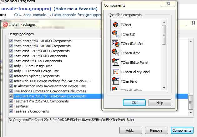

Strangely enough, TChart icon is visible, when I browse IDE menu Component->Install packages...->Design packages->Components for TeeChart.
I see, that proper 2013 Pro DclFMX is loaded, though it's still named TeeChart Pro 2012 there.
Proper Dcl FMX TeeChart package is loaded, TChart icon is shown there.
But, upon creation of new FM3 application, the TChart component is missing from design palette.

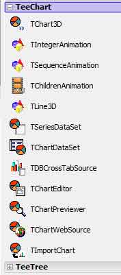

At this moment I'm not sure if the TChart Lite component was in the "TeeChart" tab where the Pro is, or if it was in another tab like "Additional". Maybe it's still where it was the Lite component. Have you tried writting "tchart" in the Tool Palette search?

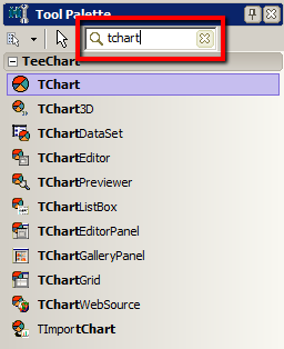

Here is what is filtered in IDE ToolPalette for FMX, when typing "tchart":
"tchart" filtered in ToolPalette

What is more, comparing your screenshot with mine, it occurred, that in my case there are no ListBox, EditorPanel, GalleryPanel, Grid components (assuming your example is taken in FMX environment as well).
