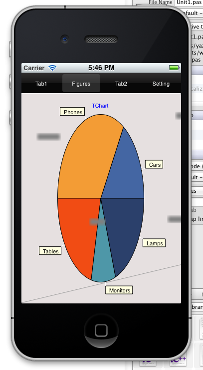

hello,
I'm testing using teechart in an iPhone app. I'm using Delphi XE2 update 4 & the last source code for tee chart.
My test code is very simple:
Series1.FillSampleValues(5);
The attached screenshot show the obtained chart in the iOS Simulator.
What are the 4 shadow rectangles ? the Marks shadow ?
Whatever the series type used I got a line staring from letdown corner !!!
Any experience with iOS firemonkey version?
Any demo for teechart on the app store ?
Is the dot net version is working better than the firemonkey version under iOS ?
Kind regards
Firemonkey iOS bug
Firemonkey iOS bug
- Screen Shot 2012-05-26 at 5.46.07 PM.png (113.36 KiB) Viewed 20918 times

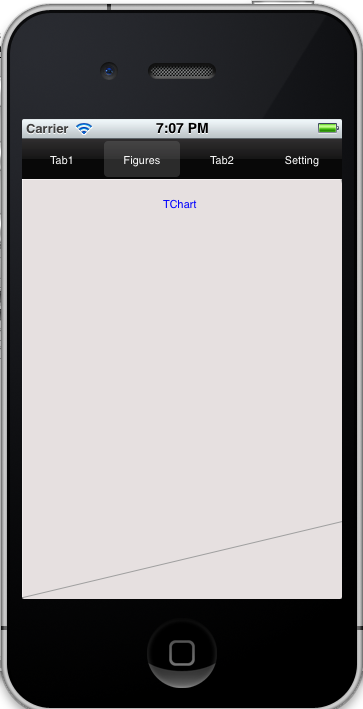

Re: Firemonkey iOS bug
Teechart draws an unwanted line even without having any series.
May be it's an axis drawing issue !!
- Screen Shot 2012-05-26 at 7.07.11 PM.png (77.13 KiB) Viewed 20870 times
Hi Yazou,
As you'll read here, there are some known problems in the iOS emulator/simulator. This would probably explain the displacement of the marks shadows.
That line being drawn in the chart could be different. However, if I'm not wrong this only happens in the emulator/simulator. Does it happen for you in a real device too?

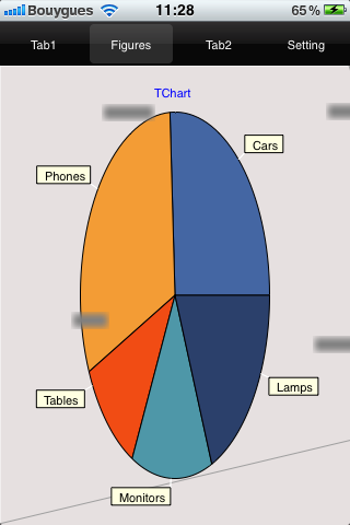

hello Yeray,
On my device (iPhone 3GS) i got the same results (see the attached screenshot of my device).
in the post of X-ray he says that teechart is working well !!
Do you have a good back of customer using the dot net version with iOS ?

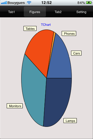

- IMG_0355.PNG (33.91 KiB) Viewed 20830 times
I made the corrections proposed in
http://qc.embarcadero.com/wc/qcmain.aspx?d=103976
and everything is right
Thank you again
Thank you again
