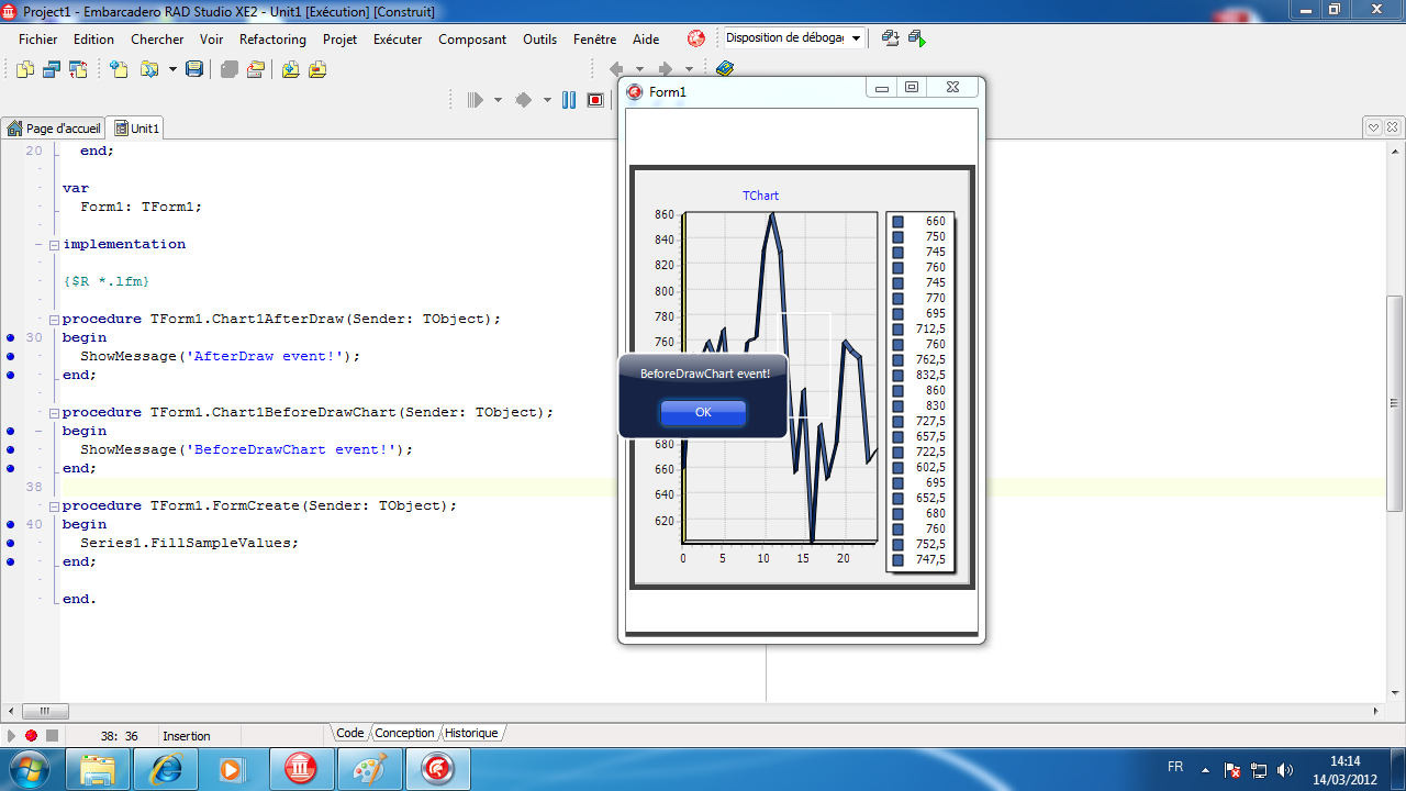

Hi Yeray
Please look at this image !
- Your Project
- Event.png (163.43 KiB) Viewed 42012 times
Re: TeeChart Speed on IOS
Hi r.lebbar,
This is not just moving the mouse over the chart but pressing the left mouse button down and then moving the mouse to draw the zoom rectangle, isn't it?
To draw the zoom rectangle, the chart has to be redrawn.
