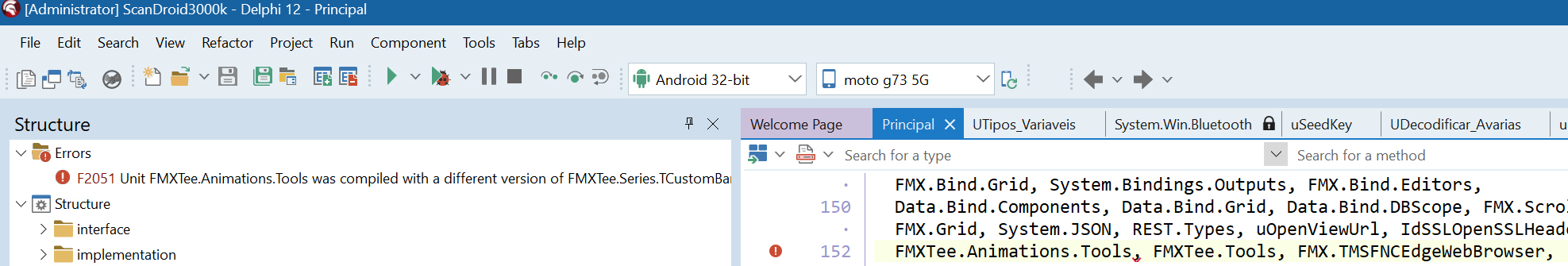

I’m using Delphi 12.3 with TeeChart VCL FMX 2025.44, and when compiling for Android (Application Store) I encounter the fatal error:
F2051 Unit FMXTee.Animations.Tools was compiled with a different version of FMXTee.Series.TCustomBarSeries
This error does not occur when compiling for the Development profile, nor when building the Windows version.
Thank you for your attention, and I look forward to your response.

I get that same error in Android 32-bit, but I get it for both "Development" and "Application Store" Configurations.
On the other hand, it seems to work fine for me here in Android 64-bit, for both Configurations.
Could you please double check to confirm we are in the same situation?

The issue also occurs when compiling for Android 32-bit under the Application Store configuration.
It’s worth mentioning that this error did not occur when I was using Delphi 12.1 — it only started after updating to Delphi 12.3.
