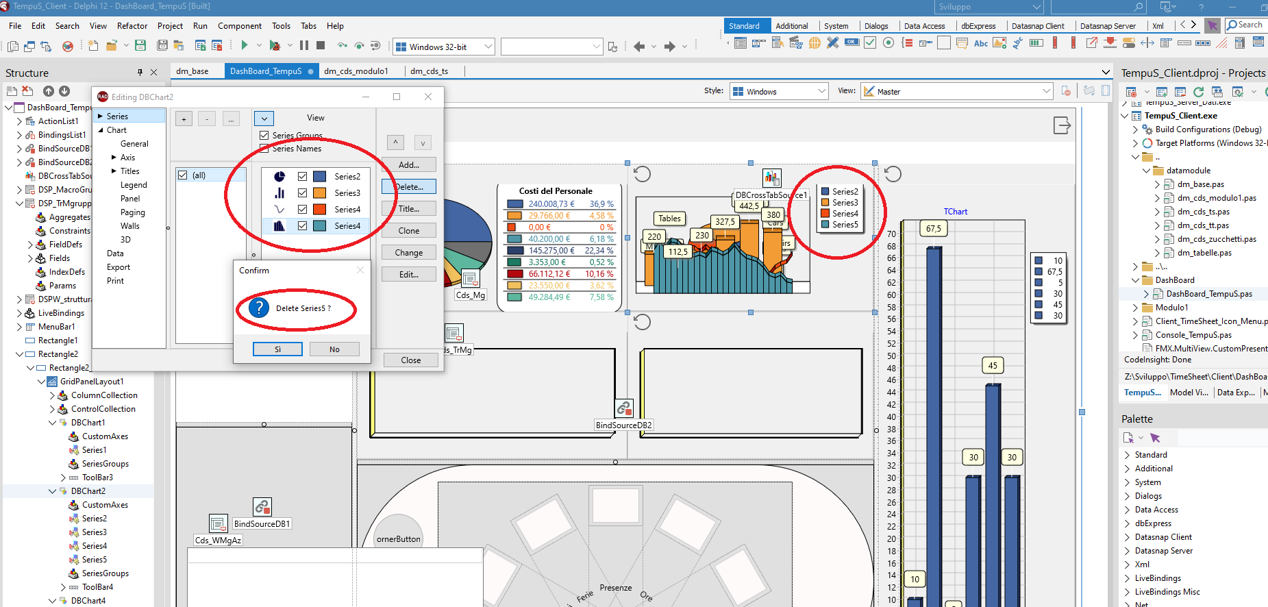

I would like to point out two bugs encountered when using tdbchart
1) If I create multiple series in the groups and delete one from that moment the series counter displays the references incorrectly

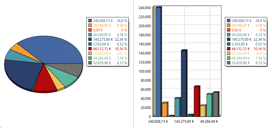

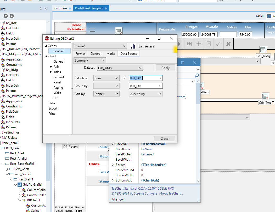

2) A persistent field of a tclientdataset set to currency is reported correctly if used in the label if used as the value of X the format is lost
(currency error.png)

- problem 2
- currency error.png (216.27 KiB) Viewed 154161 times
- problem 1
- series number error.png (244.82 KiB) Viewed 154161 times
Re: reporting two tdbchart bugs
- The
- The
Maybe we should save an internal
In the meanwhile, you could make sure you set a
When you create a series, no
Name
is set to it by default. And when a series doesn't have a Name
set, both the legend and the TChartListBox
(used to draw the series list in the Editor) use the SeriesNameOrIndex
function to calculate a string to draw each item. Then, the issues here are:- The
SeriesNameOrIndex
method gives Series1
always for the first series. If you remove the first series, then the next series will be Series1
.- The
TChartListBox
doesn't refresh when you remove a series. That's why the Editor and the Legend look out of sync. If you close the Editor and reopen it, they should be in sync again.Maybe we should save an internal
Name
when a Series is created, in a similar way as we do with the Series Color
, where we use a internal ISeriesColor
property. I've added it to the public tracker (#2694).In the meanwhile, you could make sure you set a
Name
property in your series. Ie using the GetNewSeriesName
function:
for i:=0 to nSeries-1 do
with AddSeries(TBarSeries) do
Marks.Hide;
FillSampleValues;
I'll take a look at this asap.

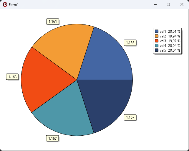

I'm trying to reproduce the problem in a simple example project without success.
This is the closest I can get to your screenshot with a simple example:
Could you modify the example above, or arrange a simple example we can run as-is, so we can reproduce the problem here?

HI

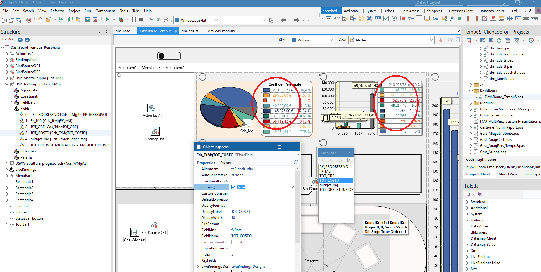

I tried to reproduce the error as best as possible, I will send you the structure and data of the table in csv format
and 2 screenshots explaining how to reproduce the problem.
I didn't write code but just used DBCHART objects and a clientdataset
I remain available to help you
Raffaele
Delphi 12.1
TeeChartVCLFMXStandard-2024.40
Raffaele
Delphi 12.1

- DELPHI 12.1 form FMX
- currency error.png (133.77 KiB) Viewed 153989 times
- currency work fine.png (125.17 KiB) Viewed 153989 times

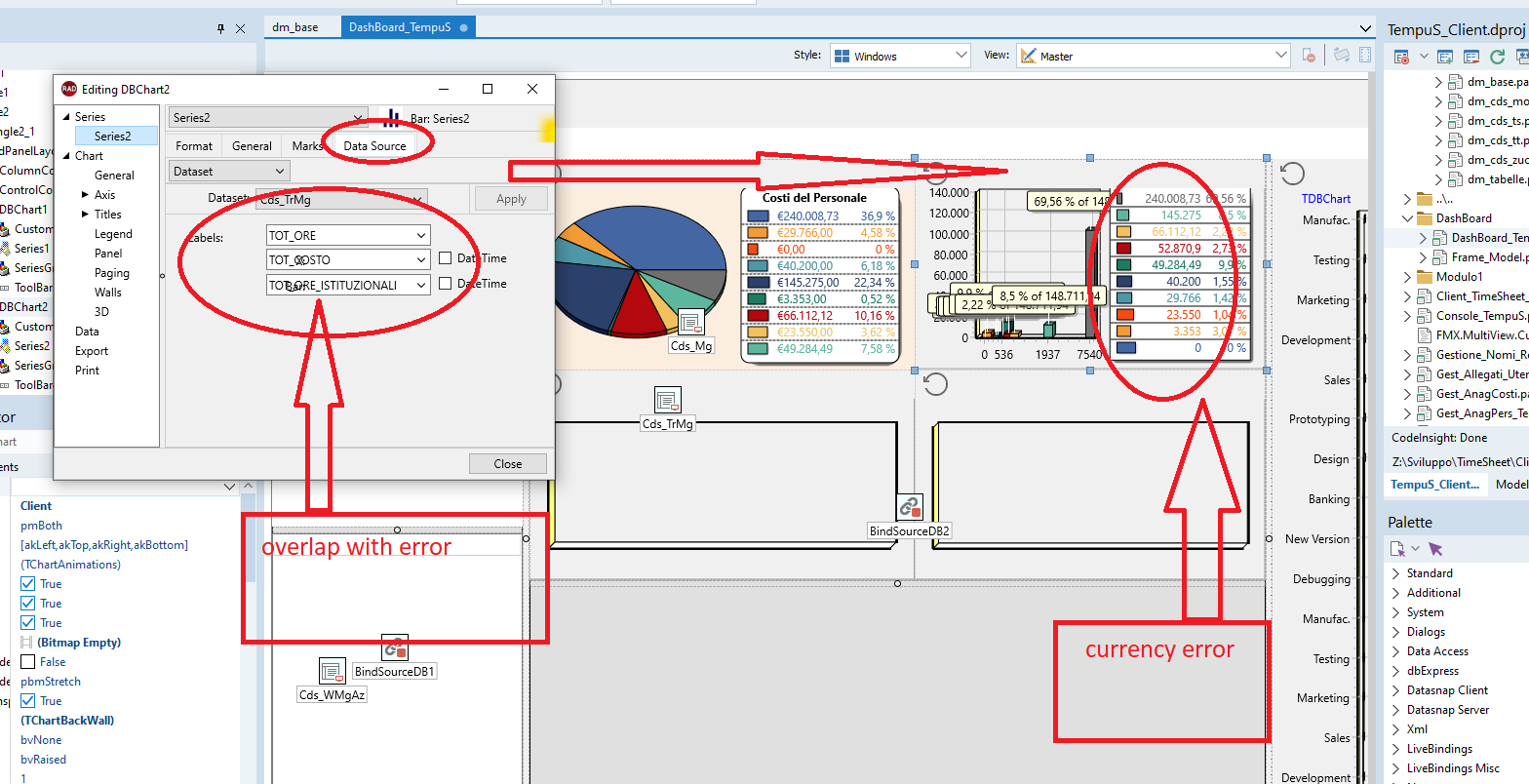

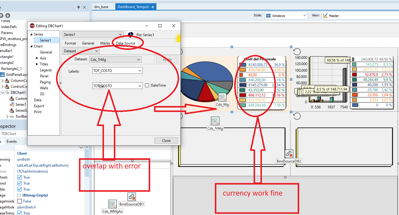

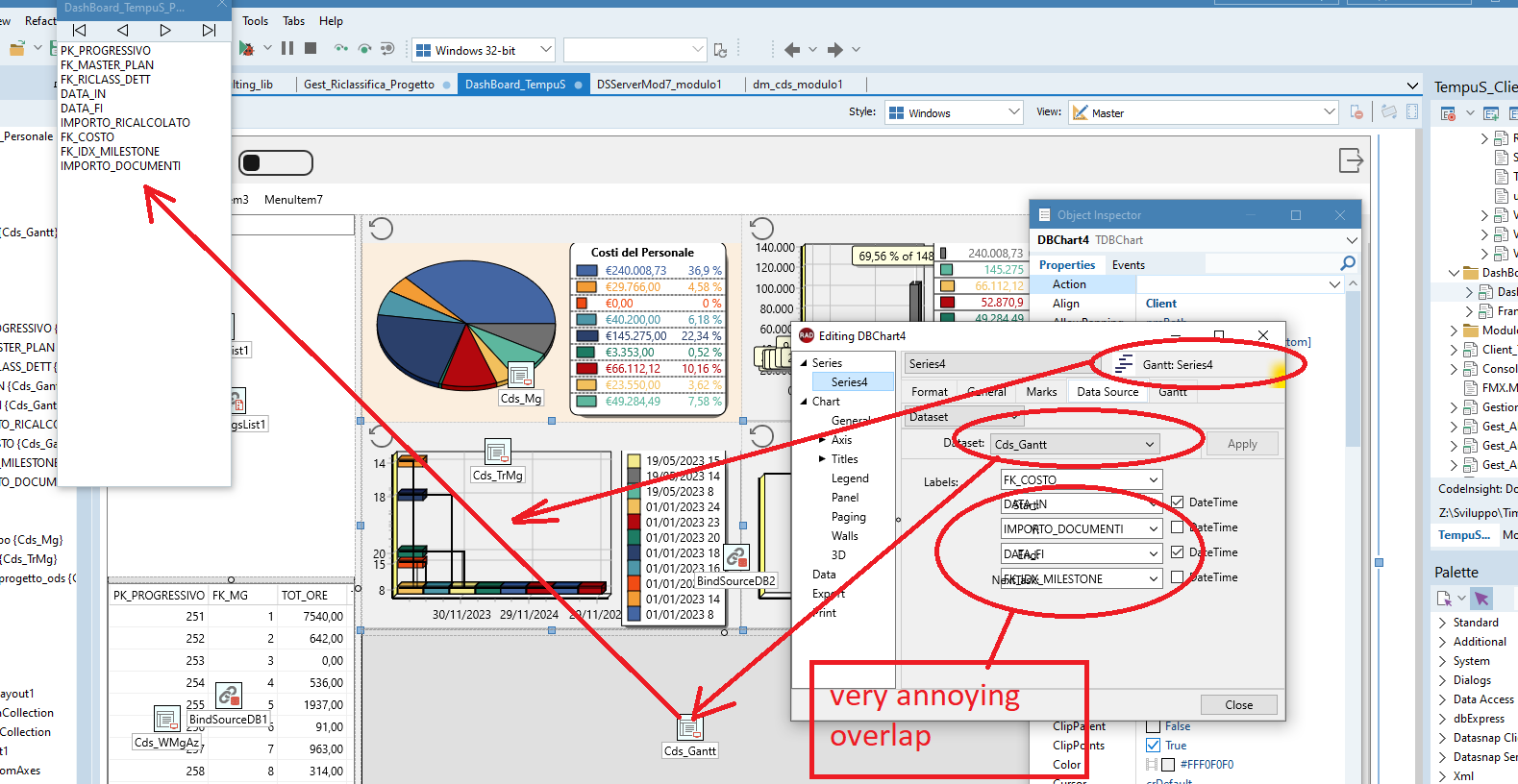

to supplement my report ": reporting two tdbchart bugs" (no response from you about this)
I attach a screenshot of a persistent and annoying label overlap when using the comboboxes for setting a dataset
Ciao
Raffaele Barone
Ciao
Raffaele Barone
- overlap label
- overlap.png (153.65 KiB) Viewed 153905 times
Hello Raffaele,
I've done a simple example in code using your dataset:
And this is how it looks for me here:
Could you please give it a try?
uses Editor.Chart, Editor.DBChart, Chart, DBChart, Series, Engine, FireDAC.Comp.Client, Data.DB;
var PieChart, BarChart: TDBChart;
var MemTable1: TFDMemTable;
procedure TForm1.EditPieButtonClick(Sender: TObject);
TChartEditForm.Edit(Self, PieChart);
procedure TForm1.EditBarButtonClick(Sender: TObject);
TChartEditForm.Edit(Self, BarChart);
var val: double;
i: Integer;
MemTable1:=TFDMemTable.Create(Self);
with MemTable1 do
FieldDefs.Add('PK_PROGRESSIVO', ftInteger);
FieldDefs.Add('FK_MG', ftInteger);
FieldDefs.Add('TOT_ORE', ftFloat);
FieldDefs.Add('TOT_COSTO', ftCurrency);
FieldDefs.Add('TOT_ORE_ISTITUZIONALI', ftCurrency);
CreateDataSet;
Open;
AppendRecord([251, 1, 7540, 240008.73, 103445.4]);
AppendRecord([252, 2, 642, 29766, 2111.22]);
AppendRecord([253, 3, 0, 0, 0]);
AppendRecord([254, 4, 536, 40200, 2306.26]);
AppendRecord([255, 5, 1937, 145275, 12641.48]);
AppendRecord([256, 6, 91, 3353, 4565.23]);
AppendRecord([257, 7, 963, 66112.12, 3308.36]);
AppendRecord([258, 8, 314, 23550, 1552.57]);
AppendRecord([259, 9, 1321.3, 49284.49, 14719.08]);
AppendRecord([260, 10, 1390, 52870.9, 4062.34]);
PieChart:=TDBChart.Create(Self);
BarChart:=TDBChart.Create(Self);
with PieChart do
Parent:=Self;
Align:=TAlignLayout.Client;
Color:=TAlphaColors.White;
Gradient.Visible:=False;
Walls.Back.Color:=TAlphaColors.White;
Legend.TextStyle:=ltsRightPercent;
Legend.FontSeriesColor:=True;
with AddSeries(TPieSeries) do
Marks.Hide;
DataSource:=MemTable1;
YValues.ValueSource:='TOT_COSTO';
XLabelsSource:='TOT_COSTO';
with BarChart do
Parent:=Self;
Align:=TAlignLayout.Right;
Width:=Form1.Width div 2;
Marks.Hide;
ColorEachPoint:=True;
Regarding the problem in the Dataset Editor, where some
TLabel
s overlap some TComboEdit
s, I've added it to the public tracker: #2700 and I've already fixed it for the next maintenance release.Best Regards,

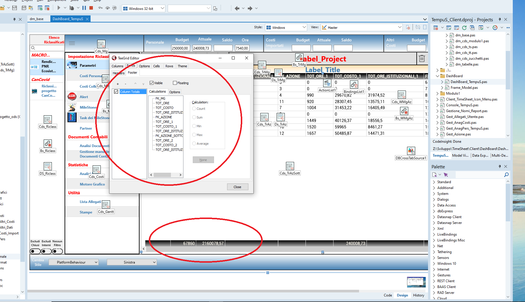

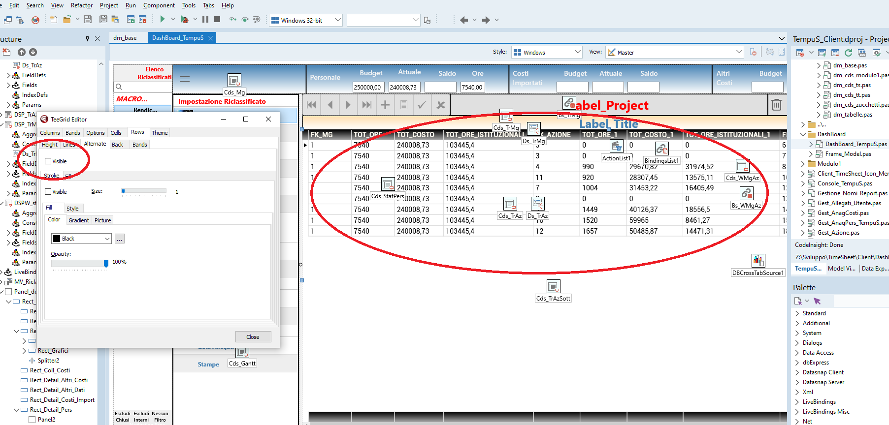

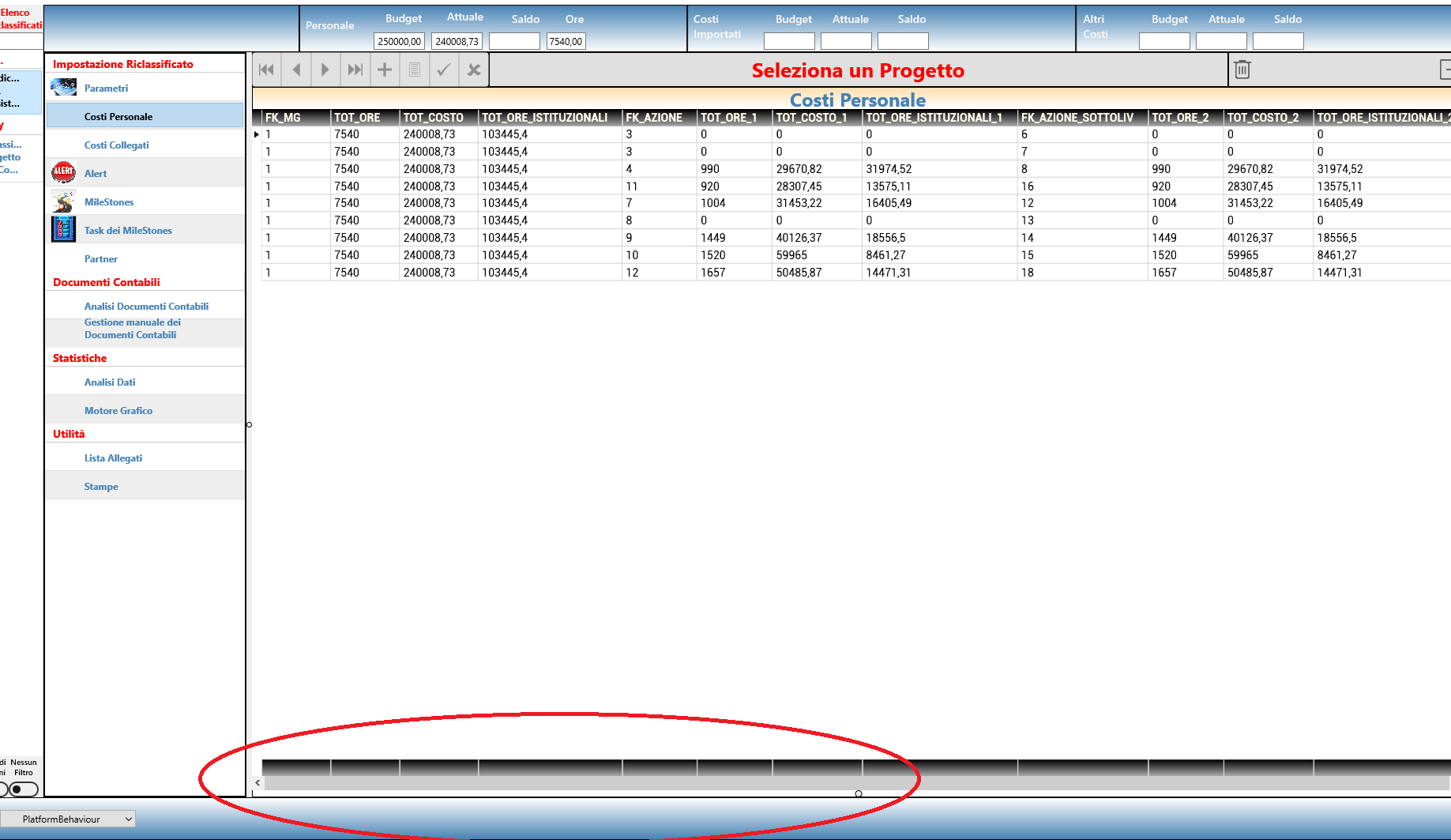

4) I would like to point out that I found another bug on the apply button of a Datasource/Summary, after having set the field and clicked on apply, if I change the field the apply remains disabled, to resolve it you need to change the Calculate (The apply button instead works correctly in the case of DataSource/Dataset) I attach a screenshot
Yesterday I renewed my TeeChart license and purchased the TeeGrid
The TeeGrid product itself is wonderful but yesterday alone I encountered numerous bugs with a TeeGrid/Dataset applied on an FMX/Rectangle or Panel.
All related to runtime visualization because at design time it seems to work.
I believe that many of the background/color properties have serious problems (probably in inheritance?).
Unfortunately more than 3 screenshots are not allowed to attach
I would like to know whether to communicate the other bugs to you or not, because in this way the TeeGrid product is truly UNUSABLE. (I attach some screen shots)
Good work and thanks for your patience but after all I also paid for the products
Ciao
Raffaele
Thank you for the example code you sent me but my application cannot use such a mechanism for the following reasons.
1) It is not a desktop but a multitier with DataSnap technology and DbExpress components therefore an FDMemTable is not conceivable.
2) The query changes dynamically so it is unthinkable to use the ADD technique from code
3) In my opinion, if the TeeChart object inspector predicts something, it must also do it.

- TeeGrid
- Teegrid Design Column Totals.png (227.31 KiB) Viewed 153281 times
- TeeGrid
- Teegrid Runtime Column Totals.png (103.77 KiB) Viewed 153281 times
- TeeChart
- series summary apply not enable.png (83.21 KiB) Viewed 153281 times
reporting teegrid bugs
as I told you in the previous post, TeeGrid on FMX suffers from several bugs
I'll point out another one regarding the alternating colors on the row
Ciao
Raffaele
Ciao
Raffaele
- Teegrid Row Alternate enable.png (151.92 KiB) Viewed 153252 times
- Teegrid Row Alternate disable.png (196.05 KiB) Viewed 153252 times

Please see this post relating to TeeGrid "Alternate":
viewtopic.php?f=21&t=18164
