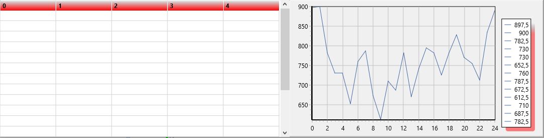

I have a TeeChart at one panel and a TeeGrid at another panel. If the chart has a legend with shadow, the grid column headers are drawn with shadow color background! There should not be a connection.

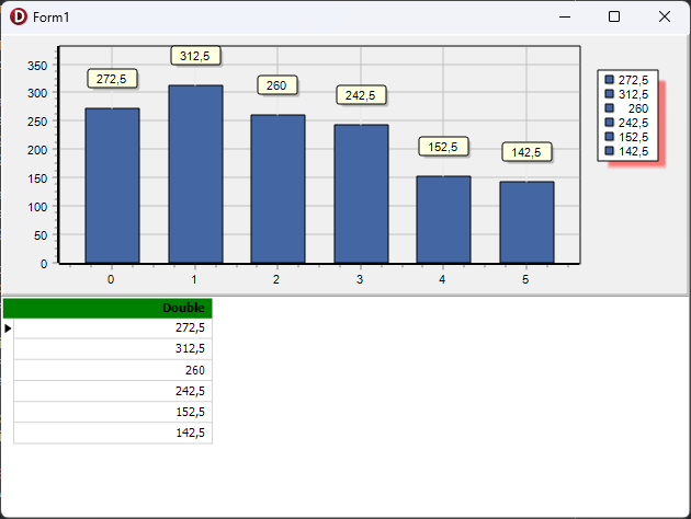

I don't see that connection with this example:
uses Tee.GridData.Rtti;
var Chart: TChart;
    Grid: TTeeGrid;
var topPanel,
    botPanel: TPanel;
    data: TChartValueList;
  topPanel:=TPanel.Create(Self);
  topPanel.Parent:=Self;
  topPanel.Align:=alTop;
  topPanel.Height:=Self.Height div 2;
  botPanel:=TPanel.Create(Self);
  botPanel.Parent:=Self;
  botPanel.Align:=alClient;
  Chart:=TChart.Create(Self);
  Chart.Parent:=topPanel;
  Chart.Align:=alClient;
  Grid:=TTeeGrid.Create(Self);
  Grid.Parent:=botPanel;
  Grid.Align:=alClient;
  Chart.View3D:=False;
  Chart.AddSeries(TBarSeries).FillSampleValues;
  data:=Chart[0].YValues;
  Grid.Data:=TVirtualData<TChartValueList>.Create(data);
  Chart.Legend.Shadow.Size:=8;
  Chart.Legend.Shadow.Color:=clRed;
  Grid.Header.Format.Brush.Gradient.Hide;
  Grid.Header.Format.Brush.Color:=clGreen;
If you still find problems with it, please modify the example above so we can reproduce the problem here, or arrange a simple example project we can run as-is here.

The effect isn't visible with your example. But with modification to LineSeries I got the issue:
My example
Re: Grid header is affected by legend shadow
Post by Yeray » Thu Nov 16, 2023 1:06 pm
I'm afraid changing from TBarSeries to TLineSeries doesn't change the Grid for me here.
