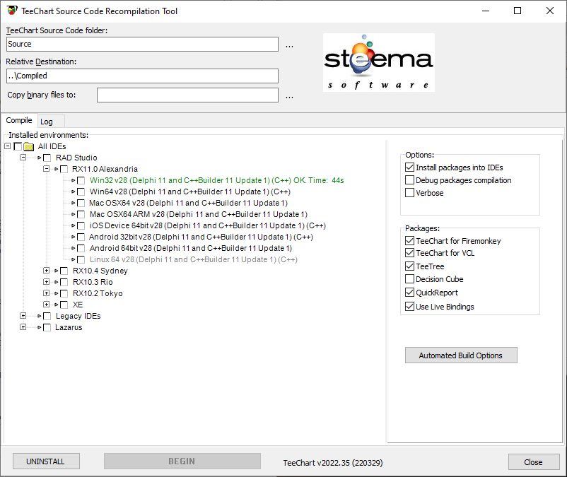

After installing TeeChart Pro VCL/FMX with sources (TeeChartVCLFMXSOURCE-2022.35.exe), you should be able to find TeeRecompile in the installation folder.
If you select at least Win32 platform for RAD 11.1 Alexandria in TeeRecompile and you build the sources you should get something like this:

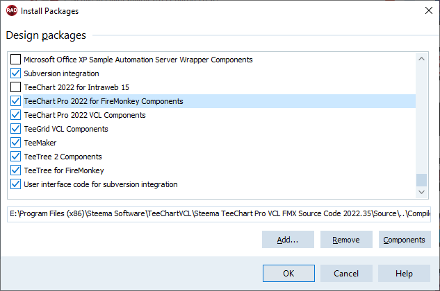

Open the IDE check the components are installed:

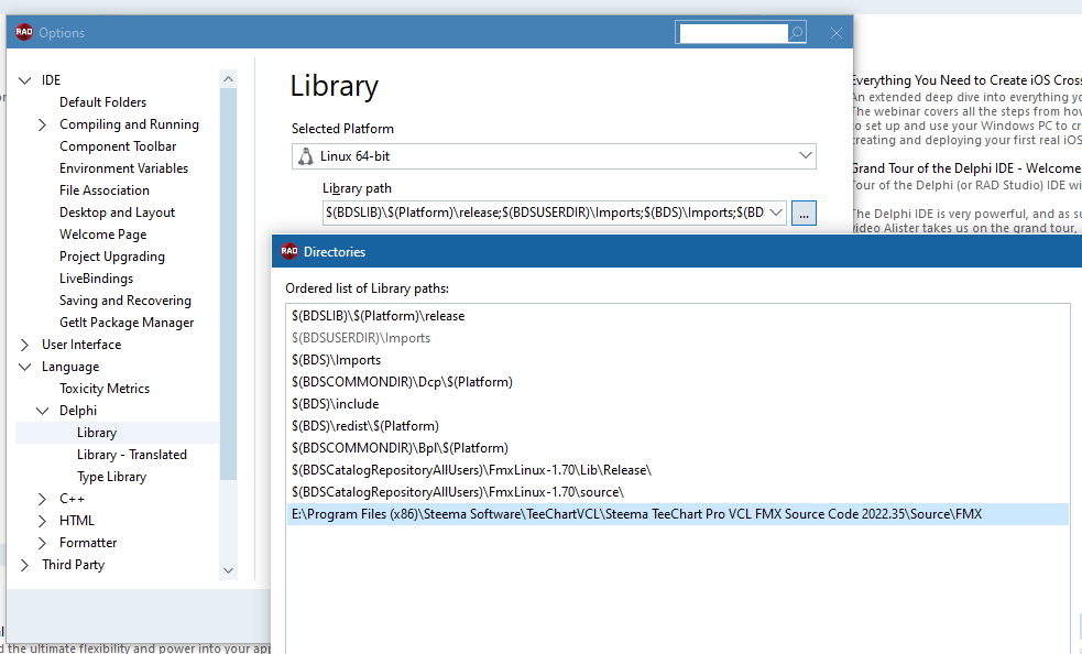

And add the "Source/FMX" path to the library path in the linux platform:

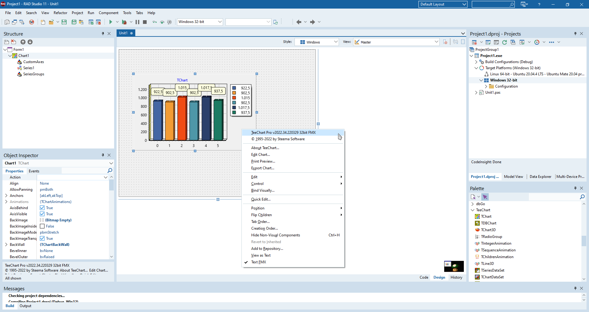

Now you should be able to drag a TChart component to the form in an FMX application, with Win32 platform selected:

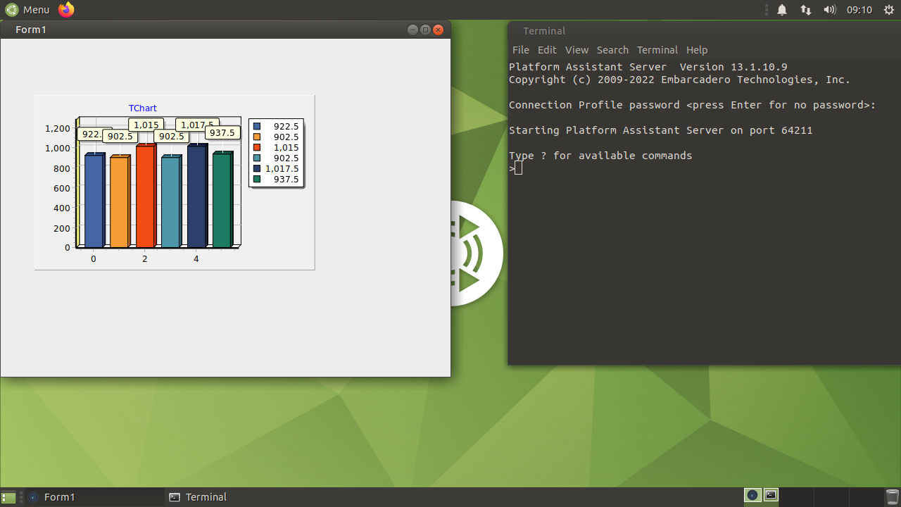

And then, you should be able to switch to the linux platform (if you have FMXLinux and the profile and the SDK correctly set in the IDE), and run the project:
