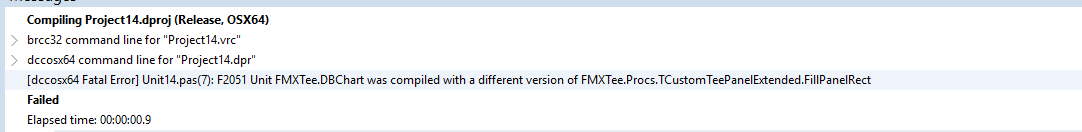

I worked with Fast Reports and they had me remove all of the .pas files from the Fast Reports OSX64 folder and got past the Fast Report errors. They had me create a new project and add just the FMXTee.DBChart to the units of the project. Attached are the errors and a zip file containing the project. Notice that on the component pallet (toolbar), all of the TeeChart components are grayed out. Not sure how, or if, I compiled TeeCharts on a fresh project, but here are my results.

Post by Yeray » Tue Sep 17, 2019 7:34 am
Sorry for the delay here.
I could open, compile and run your project without errors here.
I also created a new FMX project, added FMXTee.DBChart unit and compiled for OSX64 without errors.
Could you please share the complete "dccosx64 command line..." the IDE is trying to execute?
