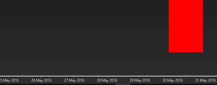

Last problem solved, however how may i delete the space between missing dates? for example i have value for 1st dec and 5th dec and 3 days in between with no data, currently it will create empty space for them, how can i remove them?

n2n wrote:how may i delete the space between missing dates? for example i have value for 1st dec and 5th dec and 3 days in between with no data, currently it will create empty space for them, how can i remove them?
This usually indicates the points are being added with an XValue - in your case a TDateTime.
I'd suggest you to convert your datetimes to strings (to use as labels) and add the values in consecutive XValues but with label. Ie:

The XValue is the array of doubles TeeChart takes to calculate the x pixel position to draw each value in the series. That's why the easiest way to change the later is by changing the first.
An alternative to keep your DateTimes next to each value would be overriding TCandleSeries adding a new array of to it. Then, your values could be drawn using XValue as always (0, 1, 2,...) and you can make the axis to show the values in the array of DateTimes in the series.
Here it is a simple example doing it:
