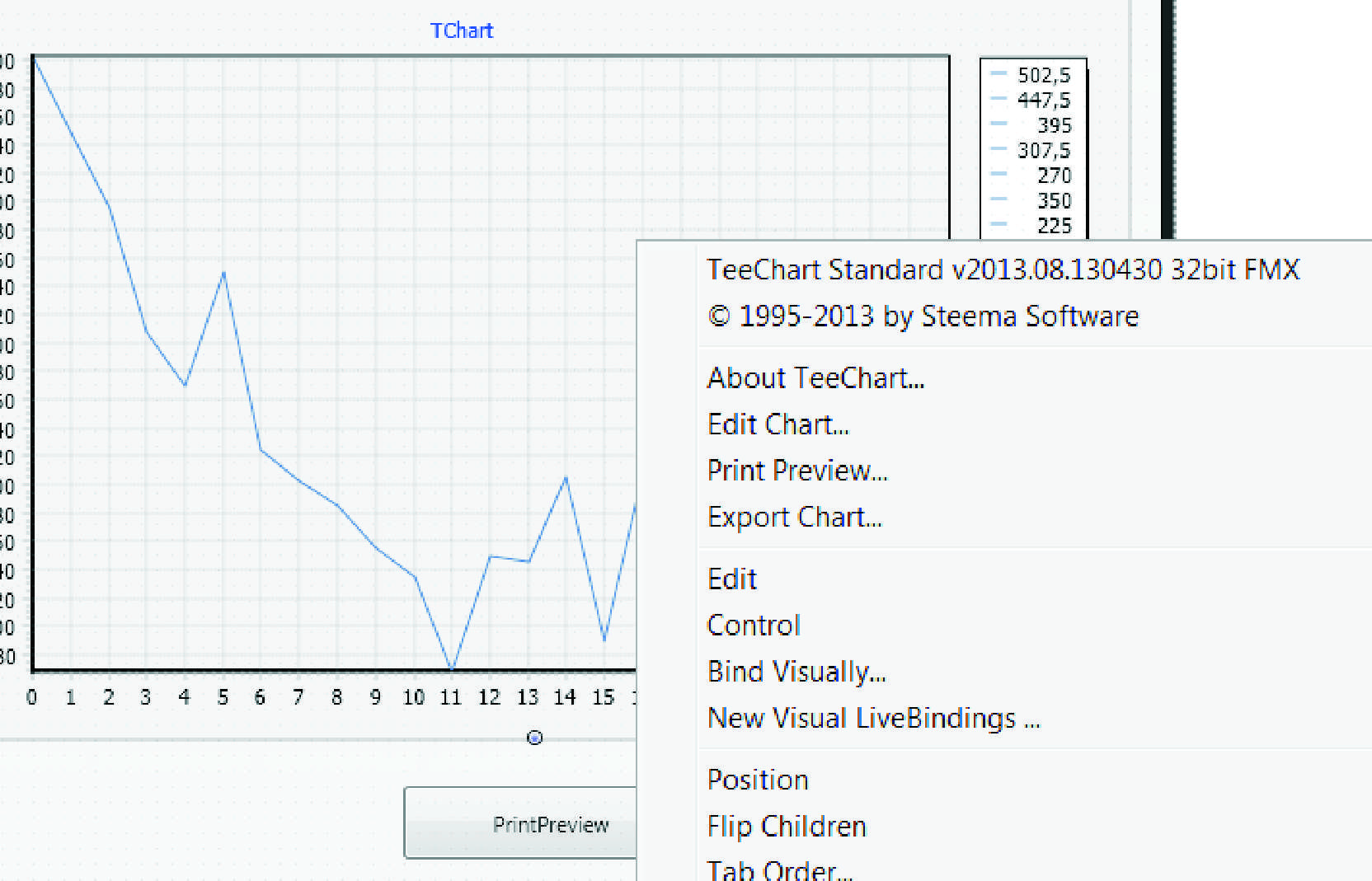

Can I call the PrintPreview or something like this with TChart Standard on XE4 Firemonkey desktop application???
(2013.08.130430 32bits FMX)

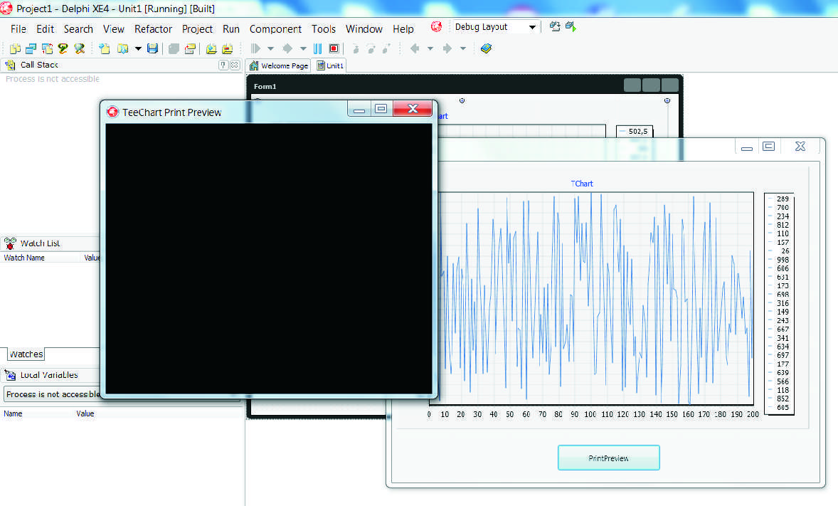

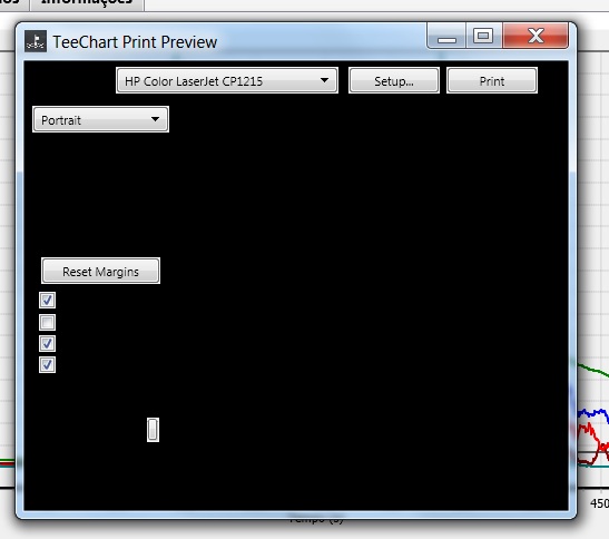

But..... I got another problem. The preview window opens with all black (see the print screen).
Your suggestion didn´t work.

Are you sure you are using the Standard version? This doesn't work for me.
uses FMXTee.Print.Preview;
  TChartPreview.Preview(Self, Chart1);
Could you please arrange a simple example project we can run as is to reproduce the black dialog in the picture?

Post by Narcís » Tue Nov 05, 2013 11:28 am
I can not reproduce this with TeeChart Pro FMX build 2013.08.130521 (latest maintenance release available) nor with the current beta. Can you please check if 2013.08.130521's eval version or the beta solve the problem at your end? Otherwise, you might expect the issue being fixed for the next maintenance release due out by the end of this week or next week the latest.
