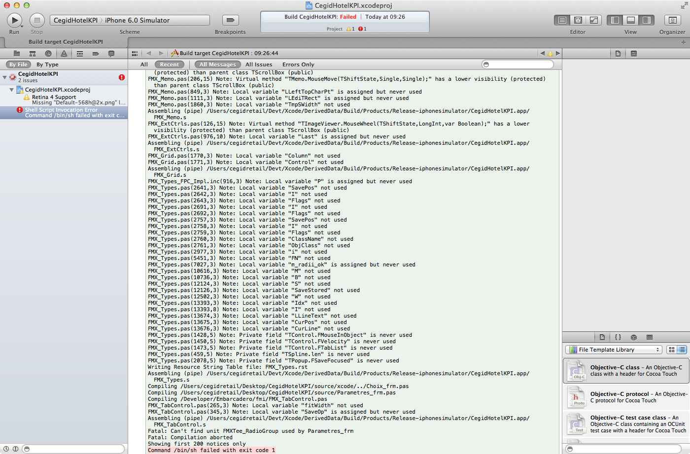

I'm a new comer in the FireMonkey/Xcode world and I've a problem to build my Delphi XE2 project into Xcode.
PC side, in Delphi XE2 Update 4 HotFix 1, I use many TeeChart units and my application works fine. All the graphics (TChart component) displays well. I installed "TeeChart2012StandardSourceCode.exe", I recompiled it and installed it. All the packages are fine installed into Delphi XE2. I've exported the project to Xcode.
Mac OS X side, I have Xcode 4.5 with Free Pascal Compiler 2.6.0 and FireMonkey-iOS.dmg (from the XE2 Update 4 HF1 installer). The installation seems OK. But when I build my XE2 project on Xcode, I obtain this error :
"Fatal: Can't find unit FMXTee_RadioGroup used by Parametres_frm".
All the "FMXTee_*.pas" are missing. I think I've missed something to do... but what ?
I was thinking that the TeeChart units exports by itself within the Xcode project. How can I specify to Xcode where are the FMXTee units ?
Here is the error details :
Compiling /Users/cegidretail/Desktop/CegidHotelKPI/source/Parametres_frm.pas
Compiling /Developer/Embarcadero/fmi/FMX_TabControl.pas
FMX_TabControl.pas(265,3) Note: Local variable "fitWidth" not used
FMX_TabControl.pas(345,3) Note: Local variable "SaveOp" is assigned but never used
Assembling (pipe) /Users/cegidretail/Devt/Xcode/DerivedData/Build/Products/Release-iphonesimulator/CegidHotelKPI.app/FMX_TabControl.s
Fatal: Compilation aborted
Showing first 200 notices only
Command /bin/sh failed with exit code 1
Does someone may help me please ?
I can upload the Xcode project if you want.
Thank you in advance,
Best regards,
Arnaud

- Screenshot.Build.Error.TeeChart.jpg (163.94 KiB) Viewed 30164 times

I found a previous post on the forum where the customer had the same error.
You had sent to him an email with a bug fix. May I have this version please ?
Arnaud

Thank you very much,Compiling /Developer/Embarcadero/fmi/FMXTee_Canvas.pas
FMXTee_Canvas.pas(626,21) Error: Identifier not found "TAlphaColor"
FMXTee_Canvas.pas(626,21) Error: Error in type definition
FMXTee_Canvas.pas(656,30) Error: Type "TColor" is not completely defined
FMXTee_Canvas.pas(658,43) Error: Type "TColor" is not completely defined
FMXTee_Canvas.pas(670,29) Error: Type "TColor" is not completely defined
FMXTee_Canvas.pas(670,29) Error: This kind of property can't be published
FMXTee_Canvas.pas(670,66) Error: Property can't have a default value
FMXTee_Canvas.pas(670,78) Error: Identifier not found "TAlphaColors"
FMXTee_Canvas.pas(682,30) Error: Illegal expression
FMXTee_Canvas.pas(805,23) Error: This kind of property can't be published
FMXTee_Canvas.pas(805,43) Error: Property can't have a default value
FMXTee_Canvas.pas(805,55) Error: Identifier not found "TAlphaColors"
FMXTee_Canvas.pas(813,23) Error: This kind of property can't be published
FMXTee_Canvas.pas(813,43) Error: Property can't have a default value
FMXTee_Canvas.pas(822,23) Error: This kind of property can't be published
FMXTee_Canvas.pas(822,43) Error: Property can't have a default value
FMXTee_Canvas.pas(822,55) Error: Identifier not found "TAlphaColors"
FMXTee_Canvas.pas(830,21) Error: Illegal expression
FMXTee_Canvas.pas(836,49) Error: Type "TColor" is not completely defined
FMXTee_Canvas.pas(869,34) Error: Type "TColor" is not completely defined
FMXTee_Canvas.pas(869,34) Error: This kind of property can't be published
FMXTee_Canvas.pas(869,77) Error: Property can't have a default value
FMXTee_Canvas.pas(870,40) Error: Identifier not found "clDefault"
FMXTee_Canvas.pas(870,40) Error: The default value of a property must be constant
FMXTee_Canvas.pas(1008,24) Error: Illegal expression
FMXTee_Canvas.pas(1035,39) Error: Type "TColor" is not completely defined
FMXTee_Canvas.pas(1050,25) Error: Illegal expression
FMXTee_Canvas.pas(1055,60) Error: Type "TColor" is not completely defined
FMXTee_Canvas.pas(1071,30) Error: Type "TColor" is not completely defined
FMXTee_Canvas.pas(1071,30) Error: This kind of property can't be published
FMXTee_Canvas.pas(1104,22) Error: Illegal expression
FMXTee_Canvas.pas(1105,22) Error: Illegal expression
FMXTee_Canvas.pas(1108,22) Error: Illegal expression
FMXTee_Canvas.pas(1122,35) Error: Type "TColor" is not completely defined
FMXTee_Canvas.pas(1139,54) Error: Type "TColor" is not completely defined
FMXTee_Canvas.pas(1139,74) Error: Type "TColor" is not completely defined
FMXTee_Canvas.pas(1141,42) Error: Type "TColor" is not completely defined
FMXTee_Canvas.pas(1143,42) Error: Type "TColor" is not completely defined
FMXTee_Canvas.pas(1146,44) Error: Type "TColor" is not completely defined
FMXTee_Canvas.pas(1156,24) Error: Illegal expression
FMXTee_Canvas.pas(1157,24) Error: Illegal expression
FMXTee_Canvas.pas(1158,24) Error: Illegal expression
FMXTee_Canvas.pas(1185,33) Error: Type "TColor" is not completely defined
FMXTee_Canvas.pas(1186,33) Error: Type "TColor" is not completely defined
FMXTee_Canvas.pas(1189,35) Error: Type "TColor" is not completely defined
FMXTee_Canvas.pas(1202,25) Error: This kind of property can't be published
FMXTee_Canvas.pas(1203,25) Error: This kind of property can't be published
FMXTee_Canvas.pas(1206,27) Error: This kind of property can't be published
FMXTee_Canvas.pas(1217,25) Error: This kind of property can't be published
FMXTee_Canvas.pas(1218,25) Error: This kind of property can't be published
FMXTee_Canvas.pas(1218,25) Fatal: There were 50 errors compiling module, stopping
Best regards,
Arnaud
