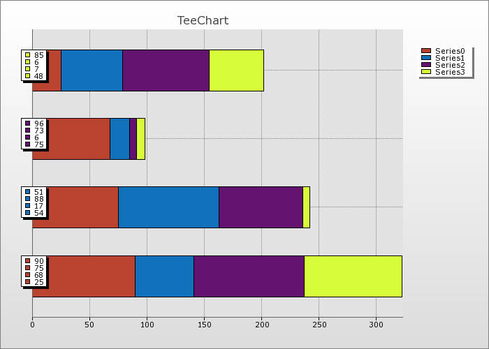

But I get a legend for each series, all them with the same color, not a legend for each valueIndex:
Re: Extra legend does not show the last mark
Posted: Mon Dec 03, 2012 1:07 pm
by yeray
Hi again,

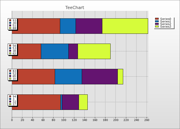

Instead of the above, you could use some dummy series for the legends. In the example below, I create a dummy series, hidden, with the values and colors to show next to each horizontal stacked bar:
    $chart->getAspect()->setView3D(false);
    for ($i=0; $i<4; $i++) {
        $bar = new HorizBar($chart->getChart());
        $bar->fillSampleValues(4);
        $bar->setMultiBar(MultiBars::$STACKED);
        $bar->getMarks()->setVisible(false);
    $chart->doInvalidate();
    $seriesCount = $chart->getSeriesCount();
    $maxCount = 0;
    for ($i=0; $i<$seriesCount; $i++) {
        $maxCount=max($maxCount, $chart->getSeries($i)->getCount());
    for ($valueIndex=0; $valueIndex<$maxCount; $valueIndex++) {
        $extraLegend = new ExtraLegend($chart->getChart());
        $dummyBar = new Bar($chart->getChart());
        $dummyBar->setActive(false);
        for ($seriesIndex=0; $seriesIndex<$seriesCount; $seriesIndex++) {
            if ($valueIndex < $chart->getSeries($seriesIndex)->getCount()) {
                $dummyBar->addYColor($chart->getSeries($seriesIndex)->getXValues()->getValue($valueIndex), $chart->getSeries($seriesIndex)->getColor());
        $extraLegend->setSeries($dummyBar);
        $extraLegend->getLegend()->setLeft(30);
        $extraLegend->getLegend()->setTop($chart->getSeries(0)->calcYPos($valueIndex));
    $chart->render();
