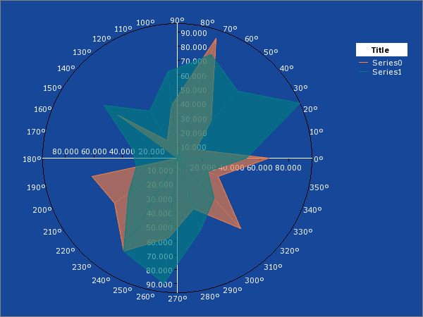

Would someone be able to post up the code (or email me) that created this chart from the All New Steema Website:
or Windrose74 if the link above fails!
That is close to what I want

The windrose in that image was made with TeeChart .NET, not with TeeChart PHP, and some of Microsoft .NET Framework drawing techniques are not available in the other frameworks.
We'll try to prepare a similar example in TeeChart PHP.

New Polar Series style added to the TeeChart for PHP (source code) version:
I'll send you the modified TeeChart PHP sources that include that new style and a demo using it.
