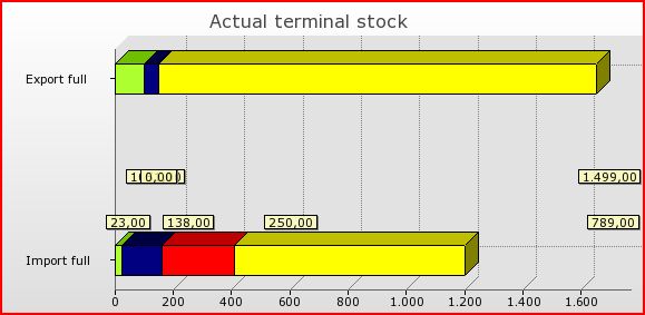

Is it possible to center the marks on a Bar and a HorizBar?
And if it is possible how do I do it?
I am using the TeeChartPHP2012.10.08.001_with_Sources version

So it's not possible right know to center a mark?
How about the Gantt() ? The mark is centered there.
Or does that work different?

Martin
Posts: 11
Joined: Tue Nov 13, 2012 12:00 am
Re: Center mark in Bar and HorizBar
Post by Martin » Wed Nov 28, 2012 11:33 am
They have indeed a custom position.
But not the position I want.
I have the bars 'stacked'.
Does that influence the behavior of the marks?
