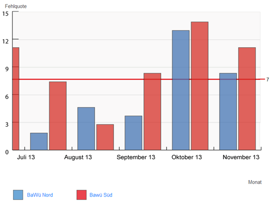

Now it's about to create a bar-chart. I need to get 2 threshold-lines in it. An upper threshold-line (green) and a lower threshold line (red).
It should look like the following (here only the lower red threshold-line is shown):
Can you give me an solution for this?
Thank you very much!
Re: Bar Chart - Threshold Lines possible?
Post by Yeray » Wed Jul 02, 2014 8:55 am
Have you checked the ColorLine tool? It is designed this very same functionality.
You can find some examples about it under "All features\Welcome!\Tools\Color Line" in the features demo shipped with the installation.

Post by Perbit » Wed Jul 02, 2014 11:48 pm
Thank you very much. It was exactly the solution I looked for. :)
