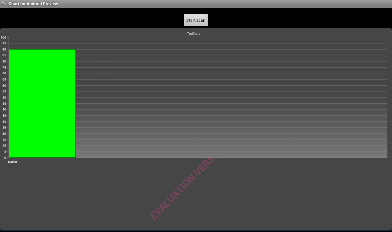

I have modified the class WIFIStatistics in the Android teechart sample to present what I'm trying to achieve.
As you can see in the attached file, when pressing the "Start scan" button, a timer is initialized to retrieve data for a few times, representing the case where a real time data flow would need
to update the graphs.

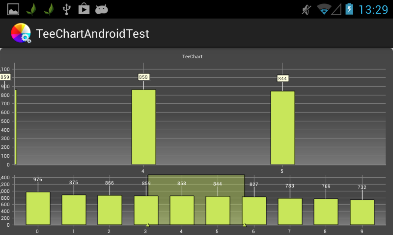

1. Issue to update the subchart
The main chart is updated without any issue. However, in order to update the subchart I ended using the following code( after a lot of tries with other functions that
did not update the subchart)
// Remove series from the scroll pager
ScrollPager s = (ScrollPager)chart.getTools().getTool(0);
if (s != null) {
	TChart scrollPagerChart = s.getSubChartTChart();
	scrollPagerChart.removeAllSeries();
	s.setSeries(null);
Although the subchart is updated, it creates a flickering effect which I would like to avoid and have a smooth update as the update of the main chart.
How can I achieve it?

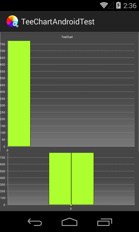

2. Issue to configure and retain state of the subchart's colorband
I need to support the following case:
a. Initially, the colorband is drawn at the default position (middle of x axis)
b. If the user changes the position or the size of the colorband, while the charts are updated in real time, the colorband should be drawn at the new position and its size
should be updated accordingly.
I tried different functions from the library and tried to implement relevant events to accomplish this, however, unsuccessfully.
Currently, the code used in the attached sample uses the default configuration of the colorband each time it gets updated. If you try to move the colorband while
the subgraph is updated, you will get an exception.
Could you please provide some sample code how to retain the colorband's position and size and also avoid the exception?
This feature is very important for the functionality I'm implementing.

Eliana wrote:1. Issue to update the subchart
if (s != null) {
	s.setSeries(null);
It works fine for me if I change your code for this:
			if (s != null) {
				/*scrollPagerChart.removeAllSeries();
				s.setSeries(null);*/
				Series series = availableNetworks.cloneSeries();
				series.setChart(null);
				scrollPagerChart.getSeries().add(series);
Eliana wrote:2. Issue to configure and retain state of the subchart's colorband
If I understood in correctly, the change suggested above also makes this to work as you want.
Note the ScrollPager setSeries function calls some functions to set the layout of both the superior and the inferior charts.
The way I've done it, you are just avoiding the layout&aspect&colorband settings. Note they have already been called at the example startup, so it is not needed any more.

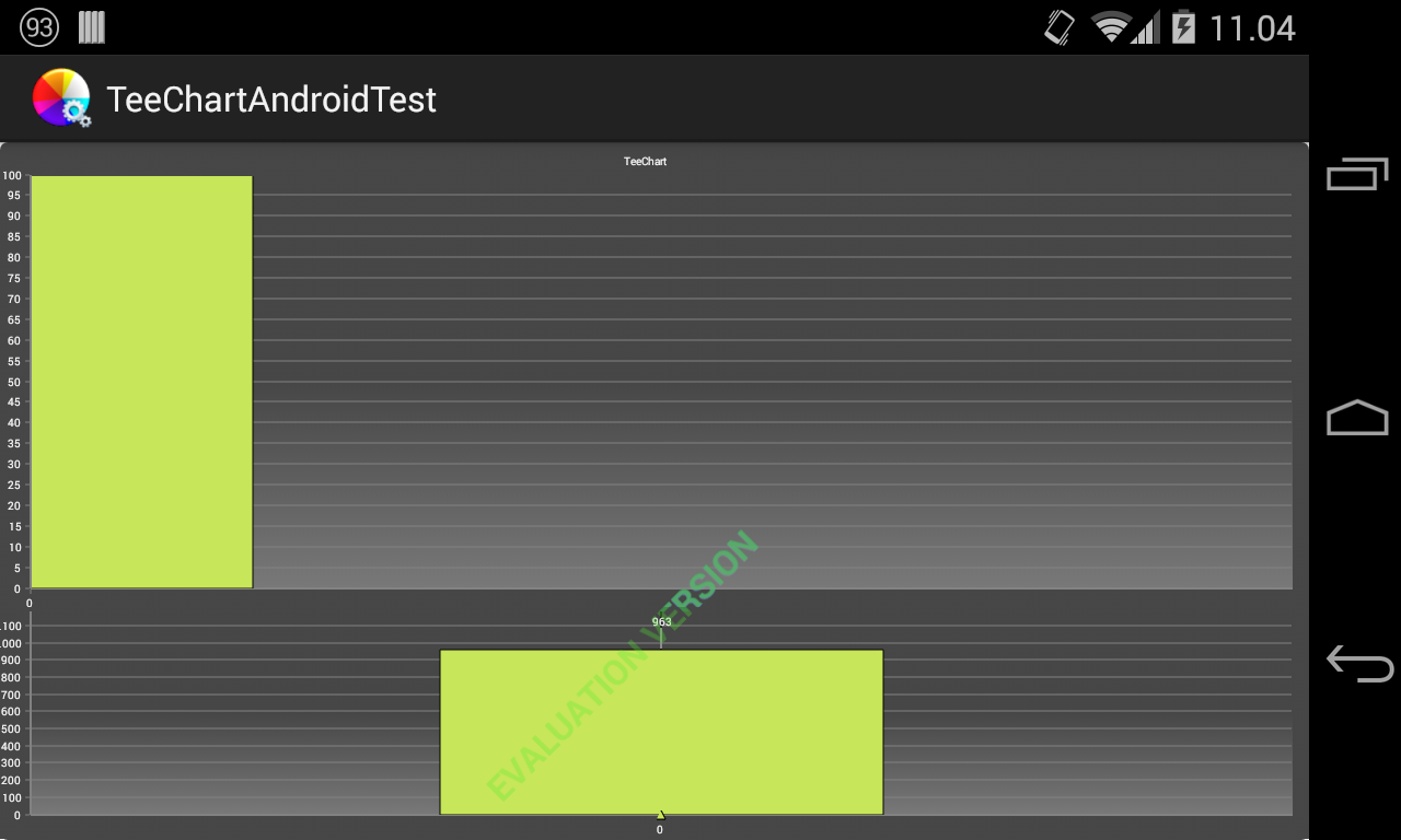

Thanks for the change and the great support, it has solved my issues but I need some further assistance on the second issue.
I need to save the position/size of the colorband and propagate it in case configuration changes. This is for the case where you change the orientation of the device.
So, if the user is using landscape view and has moved/resized the subchart's panel, I would like to retain the updated position/size of the colorband at the portrait view.
I tried to configure the dragFinished event and then call the getStartLine and getEndlLine on the colorband but unsuccessfully. It seems that I have not configured the event correctly (how do you register the draglistener and where? on the scrollpager or on the colorband?) or I should have used something else to achieve what I want.
Could you please provide me with some sample code?
Also, I tried to set a legend below the subchart, however it does not show it. Is it possible to show a legend below the main chart or the subchart?
E.

Eliana wrote:Also, I tried to set a legend below the subchart, however it does not show it. Is it possible to show a legend below the main chart or the subchart?
setSeries() also sets some aspect properties to the more common settings for a scrollPager (2D, no legend, horizontal zoom,...)
So, if you want to revert any of these settings, you should do it at chartPainted, after the setSeries call. Ie:
    	chart.addChartPaintListener(new ChartPaintAdapter() {
			@Override
			public void chartPainted(ChartDrawEvent e) {
					if (s.getSeries() == null) {
						s.setSeries(chart.getSeries(0));
						ThemesList.applyTheme(scrollPagerChart.getChart(), 1);
						chart.getLegend().setVisible(true);

I tried to use the setNoLimitDrag to true in the chartPainted event in an effort to allow dragging over the chart area, but the exception still occurs.
2. In the case where there is only one bar drawn, the bar shows in the main chart but the subchart does not show.
a) I would like to show the subchart, even with just one bar, and then
b) set the subchart panel location so that it includes this single bar.
How do I achieve this?
Eliana.

This is how it looks for me if I have a single bar:
Is this the problem you are observing?
Here it is the code I used to get the above:

Eliana wrote:2. I'm still having issues when a single bar is displayed. Please consider the file I have attached at my previous post in order to reproduce the problem. The following screenshot displays my problem where only the main chart is shown:
I've made a simple example project to test this out of the Features demo because I don't ever get a unique bar here.
TeeChartAndroidTest.zip
(678.38 KiB) Downloaded 2460 times
And this is what I get:
Could you please modify the project above so we can reproduce the problem here?

After having a look at the example project, I have updated the library to the latest version and the issue with the single bar has been solved.
Also, thanks for the code provided regarding the colorband position, it covers the main requirements so no further investigations are needed.
I do have an issue which I don't recall if it happened prior to updating the library. I have modified the sample project you provided to show more bars and reproduce the issue. As you can see in the following screenshot, the mark above the bar at the edge of the main chart appears outside the main chart area and on top of the y axis.
Is there a way to avoid this from happening?
