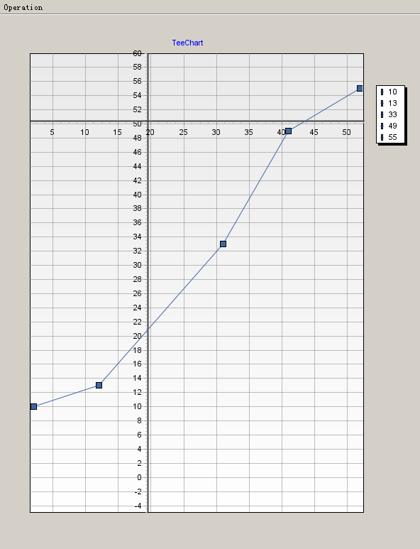

Post by rubby » Thu Feb 27, 2014 2:08 am
I wan to draw a graph whose left axis and bottom axis cross at point(15,10). Please refer to "correct.png".
However, when i use the following code, the axis of graph are not at the correct position. please refer to "wrong.png".
I create a method "setXYAxisCross" to implement the function.
do i misunderstand the use of
setPositionUnits();
setRelativePosition();

    public void setXYAxisCross(TChart chart, int offset_x, int offset_y) {
        Axis bottom = chart.getAxes().getBottom();
        Axis left = chart.getAxes().getLeft();
        int y = left.calcPosValue(offset_y);
        bottom.setPositionUnits(PositionUnits.PIXELS);
        bottom.setRelativePosition(y);
        int x = bottom.calcPosValue(offset_x);
        left.setPositionUnits(PositionUnits.PIXELS);
        left.setRelativePosition(x);

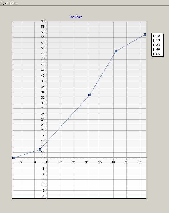

rubby
Posts: 38
Joined: Mon Aug 12, 2013 12:00 am
Re: How to specify the coordinate origin
Post by rubby » Thu Feb 27, 2014 2:11 am
i am sorry.
The wrong.png is here.
rubby
Posts: 38
Post by rubby » Thu Feb 27, 2014 2:35 am
Luckily, i finally make it work correctly now. :)
// bottom.setRelativePosition(y);
bottom.setRelativePosition(left.iEndPos-y);
// left.setRelativePosition(x);
left.setRelativePosition(x-bottom.iStartPos);
I hope this poster will be useful for the guy who needs this function too.
