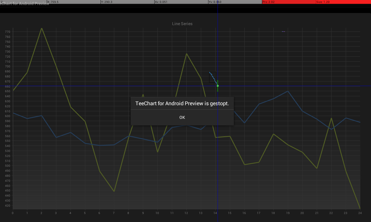

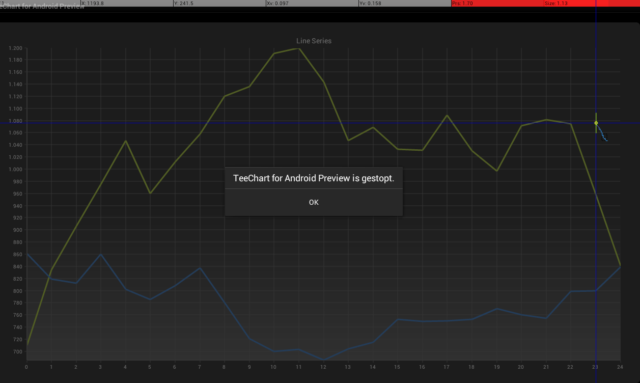

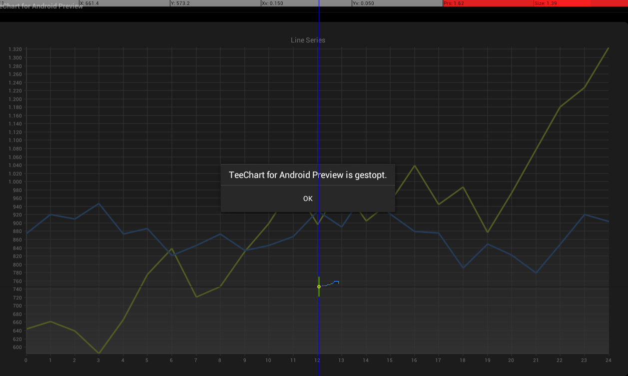

Hello
I have reproduced the problem and i used a tool to see what kind of motion was made before it crashed.
Reproduced on : Motorola Xoom 2

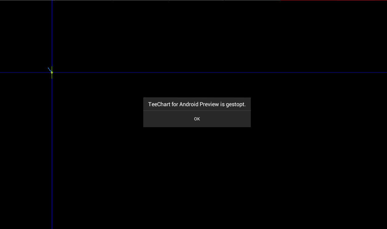

Here is the fourth picture.
