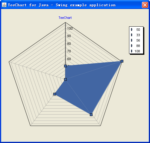

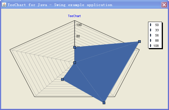

My code is as follows.
In the attachment, you can find two png files.
In the first png (radar1.png), you will see the radar graph is wrong.
In the second png(radar2.png), you will find that the value "33" is not showed correctly either.
Thus, when user changes the size of the dialog, the radar graph changes in a wrong mode.

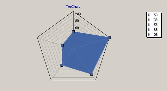

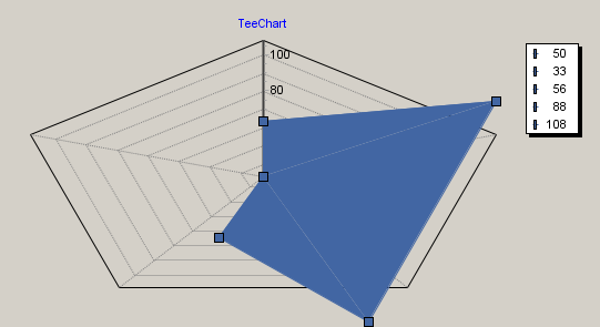

rubby wrote:In the first png (radar1.png), you will see the radar graph is wrong.
This code:
Radar series1 = new Radar(tChart1.getChart());
series1.add(50);
series1.add(33);
series1.add(56);
series1.add(88);
series1.add(108);
Gives me this:
That looks as your radar1.png image. However, I'm not sure to find any alternative in your code to generate the radar2.png.
Also, in radar2.png I think the value "33" is drawn correctly. Note it's the lower value in the series, so the axis minimum starts on it by default, so it's drawn on the center.
Then, adding this:
series1.setCircled(true);
I think will give you the expected result for radar1.png.
And adding this:
series1.getVertAxis().setAutomaticMinimum(false);
series1.getVertAxis().setMinimum(0);
I think will draw the "33" where you'd expect.

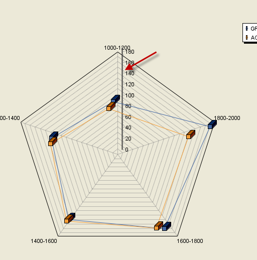

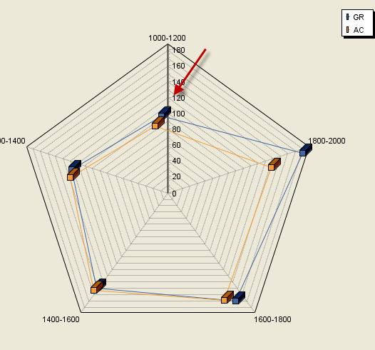

I encounter a strange problem with radar graph.
the axis is not in the right position.【radar axis wrong position.png】
what i need it the one in the attachment 【radar correct position.png】.
How can i set the current position of this axis by myself.
is it radar.getVertAxis()... or something else?

Re: problem with radar
Post by Narcís » Thu Feb 20, 2014 9:55 am
Hi rubby,
I can not reproduce this. Are those screen-shots made with different TeeChart versions? Otherwise, which settings differ from one chart to the other?
