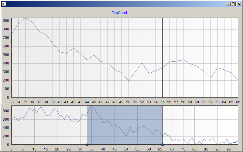

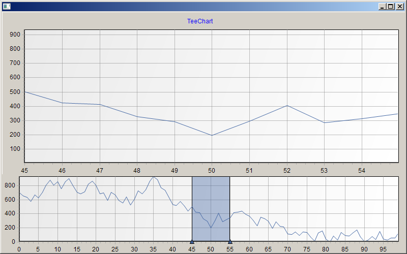

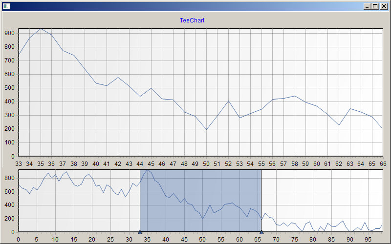

You can use the divisionRatio for this. You can get it's value through getDivisionRatio() and you can set a new one through setDivisionRatio(double value). By default its value is 3. The height of the TSubChart below is the result of the division of the main chart height between this divisionRatio value.SetOnHi wrote:In the ScrollPagerDemo code
the size [height] of the lower window is fixed.
Is it possible to adjust the height?
It seems to work fine for me. Look at the following screenshots: This is the code I used, with TeeChart Java SWTSetOnHi wrote:Also it seems the lower panel used to scroll is not using gridbag layouts so that when I resize the main window the lower panel is not resized automatically.
Is this true?
This cannot be used for commercial use without this feature [ autoresizing ]
tChart1.getLegend().setVisible(false);
Line line1 = new Line(tChart1.getChart());
line1.fillSampleValues(100);
tChart1.setBounds(Utils.fromLTRB(0, 0, tChart1.getParent().getSize().x, tChart1.getParent().getSize().y-20));
ScrollPager scroPag1 = new ScrollPager(tChart1.getChart(), tChart1.getParent(), 0);
scroPag1.setSeries(line1);
