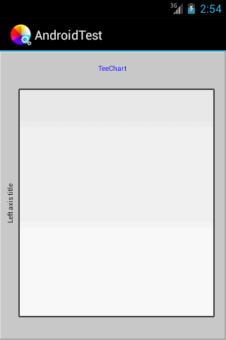

Re: Vertical title not horizontally center-aligned
Post by Yeray » Tue Apr 30, 2013 2:59 pm
This is how a default chart looks for me.
I just set it to 2D and defined a left axis title:
	private TChart tChart1;
	@Override
	public void onCreate(Bundle savedInstanceState) {
		super.onCreate(savedInstanceState);
		setContentView(R.layout.main);
		LinearLayout group = (LinearLayout) findViewById(R.id.chart_layout1);
		tChart1 = new TChart(this);
		group.addView(tChart1);
		tChart1.getAxes().getLeft().getTitle().setText("Left axis title");
It may be some property you've set that could be relevant to reproduce it. Could you please arrange a simple example project we can run as-is to reproduce the situation here?
