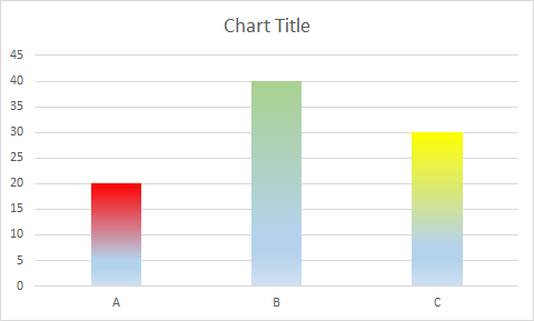

Now I'm asking for different gradients for different bars (obviously in the same Bar class instance). Please see attached image.

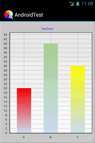

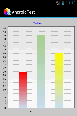

This would let you define the colors without having to handle any event. But we have then a problem with the bottom axis labels:
So I'd better rectify my suggestion: I'd continue using a unique Bar series with three points in it, and using the BarStyleResolver event to modify the gradients:
		tChart1.getLegend().setVisible(false);
		Bar bar1 = new Bar(tChart1.getChart());
		bar1.getPen().setVisible(false);
		bar1.getMarks().setVisible(false);
		bar1.getGradient().setVisible(true);
		bar1.getGradient().setUseMiddle(false);
		bar1.getGradient().setEndColor(Color.fromArgb(205, 224, 242));
		bar1.add(20, "A", Color.red);
		bar1.add(40, "B", Color.fromArgb(170, 210, 145));
		bar1.add(30, "C", Color.yellow);
