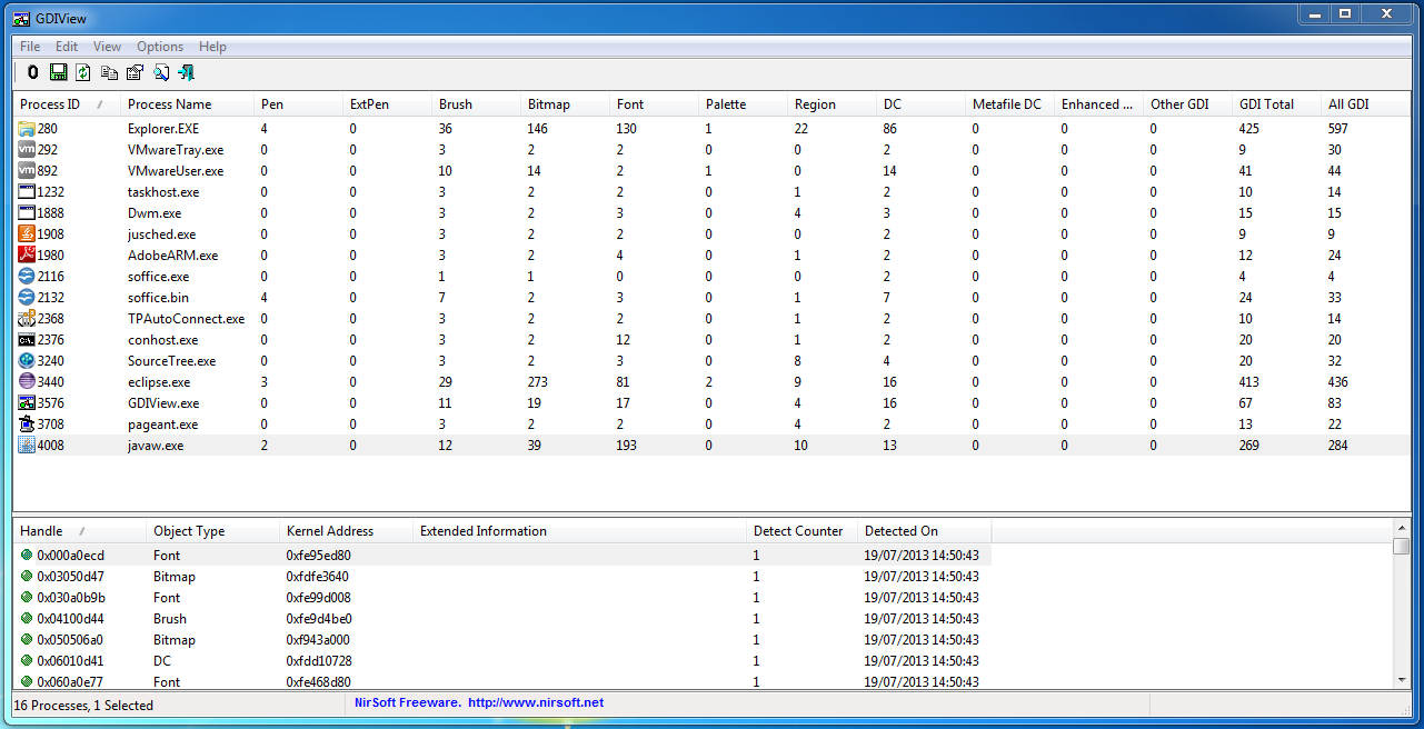

But there is still a memory leak with fonts... for example try to move mouse over a chart, it increases gdi.
Here I attach a screenshoot of gdiview of my application (pid 4008) after a some time.
Screen shot 2013-07-19 at 2.51.29 PM.png (96.34 KiB) Viewed 45077 times
