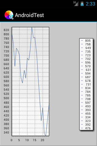

		tChart1.getHeader().setVisible(false);
		Line line1 = new Line(tChart1.getChart());
		line1.fillSampleValues();
		tChart1.getLegend().setHorizMargin(100);
Android emulator, v4.2.2

That looks like 100 pixels on the left. What about the right side? In my app it touches the border of the entire TChart view.
