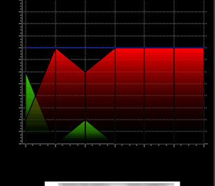

It looks like I've set up my Area chart incorrectly:
Series ln = new Area(tchart.getChart());
((Area)ln).getAreaLines().setVisible(false);
((CustomPoint)ln).setStacked(CustomStack.NONE);
[do a loop here]
DateTime dt = new DateTime(blah,blah,blah);
ln.add(dt, double(DurationData.get(i).getDuration /60 /60));
[end loop]
It seems to work ok, but would be nice to instantiate it correctly.

Now I'm not sure that Area is what I want. Is there a way to shade below the lines of a line chart?
Re: Axis color
Post by Yeray » Wed Feb 20, 2013 8:13 am
Hi Dave,
I'm not sure to understand what you mean. Could you please explain it with more details? Adding some image may help too.
DaveSav
Posts: 18
Joined: Wed Jun 15, 2011 12:00 am
Re: Axis color
Post by DaveSav » Wed Feb 20, 2013 8:55 pm
Before buying TeeChart, I was using aChartEngine, and you could add a transparent shading below each series line, as in the image below.
Dave
Re: Axis color
Post by Yeray » Fri Feb 22, 2013 1:12 pm
Hi Dave,
You can set the transparency to the Area series as here:
	    	  Area area1 = new Area(tChart1.getChart());
	    	  area1.fillSampleValues();
	    	  area1.getAreaLines().setVisible(false);
	    	  area1.setTransparency(50);
Or something more similar to your image, with wider lines, blue transparent areas, pointer visible for one of them...
