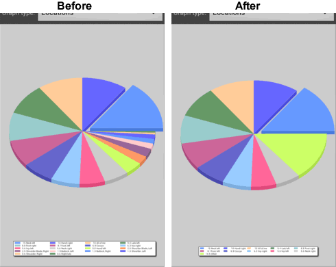

Is there a way to change the font size of the Legend?
In testing (with Galaxy S3), I have a Pie chart with 18 entries. The Legend is hard to read as the text is too small. I thought I would change the data and group everything below 5% into an 'Other' entry, which left me with 14 entries. I expected the font size to increase as it had more space, but nothing happened.
I also looked for something like
tChart1.getAxes().getLeft().getLabels().getFont().setSize(10);
from the answer given at http://www.teechart.net/support/viewtop ... ize#p55692 but couldn't find anything.
Here is the 'Before & After' image:
Please advise on how to make the Legend text readable

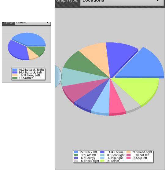

Having said that;
The above example is using Galaxy S3 as a test device, which is XHDPI
The below image is from a test using Galaxy Ace, which is MDPI, and that looks fine. Could it be to do with how TeeChart renders XHDPI?

Post by DaveSav » Tue Jan 08, 2013 11:25 pm
Thanks Yeray,
I tried your setsize(20) answer and, although it made the xhdpi legend text more readable, it also scaled up every other dpi, which made the screen look stupid. Images are below...
I would say that this issue should be removed from the 'wish list' and added to 'urgent action', as this affects every serious user of your solution.
(Note: Different devices, different data)
Left device is MDPI, Right device is XHDPI
