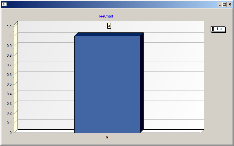

I have the same problem, but I am not using MultiBars.
public NewJFrame() {
try {
initComponents();
setSize(new Dimension(500, 500));
Bar b = new Bar();
b.getMarks().setVisible(true);
t.getChart().addSeries(b);
b.add(1, 1, "a");
jPanel1.add(t,BorderLayout.CENTER);
} catch (Exception ex) {
Logger.getLogger(NewJFrame.class.getName()).log(Level.SEVERE, null, ex);

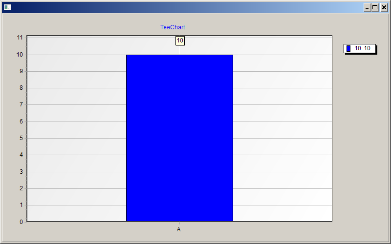

I'd say I'm getting the expected result here in both cases.
Jonathan's code creates a bar series, adds a point with "A" label, changes the point label to "10" and uses custom labels on the bottom axis to show an "A" on the 0 value:
WhebJava code creates a Bar series and adds a point with "a" label:
Please, explain what result would you expect.

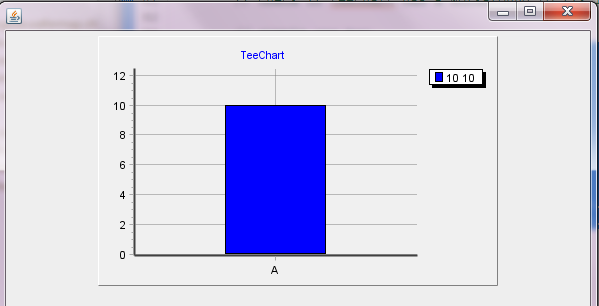

Post by Jonathan » Fri Aug 03, 2012 4:38 pm
I don't see that expected chart in my end. I attached a chart when I ran the sample codes above. As you can see, I don't see the bar label "10".
Missing bar label.png (30.96 KiB) Viewed 31093 times
