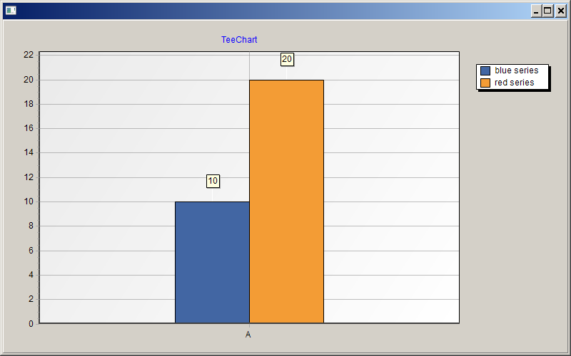

Post by Yeray » Fri Jul 27, 2012 8:26 am
Hi Jonathan,
This is what I'm getting with your code:
I don't see what's wrong. I understand this is the result I'd expect with your code: Two side bars with one point each one. Their labels are "A" and "B" when you add the points, then you change them to "10" and "20". And you finally use custom labels in the bottom axis to just show a "A" at the 0.
Could you please explain again what result would you expect?

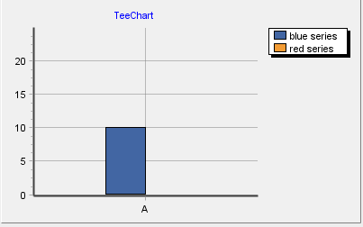

Your chart is exactly what I expect to see. However, for some reasons, I am not getting that chart, but the following instead: (With Teechart V2 version and TeeChartJavaSuite_2012Eval.zip, I am seeing the same result - missing bars [missing red series in the sample codes]) I attached mine: Could you tell me what is missing/wrong?

Post by Jonathan » Mon Aug 06, 2012 3:14 pm
Since the max. allowed size is 512 KB, I had to remove the lib file. I attached the whole testing application (using Eclipse) in zip. What version of teechart lib were you using? Was it same one as mine (version2) ?

Post by Yeray » Wed Aug 08, 2012 12:01 pm
Hi Jonathan,
Thanks to your application I could reproduce it. It seems it only happens in the swing version.
I've added it to the defect list to be revised asap.
