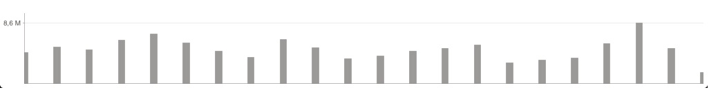

i have a bar chart like this:

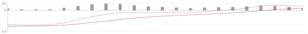

now i want a MACD view like this:
How can i use the MACD function? I cannot find an example in the tutorials?
Thanks for ur help!
Michael

Hi Michael,
There is an example of the MACD function in the features demo program at "All Features\Welcome!\Functions\Financial\MACD".
Here it is the main code:
	protected void initChart() {
		super.initChart();
        chart1.getHeader().setVisible(true);
        chart1.setText("MACD Function Example");
        chart1.getAspect().setView3D(false);
        candleSeries = new com.steema.teechart.styles.Candle(chart1.getChart());
        candleSeries.getMarks().setVisible(false);
        candleSeries.getPointer().setVisible(true);
        candleSeries.setTitle("Candle");
        candleSeries.getVertAxis().setStartPosition(0);
        candleSeries.getVertAxis().setEndPosition(40);
        candleSeries.getVertAxis().getTitle().setCaption("Candle");
        candleSeries.fillSampleValues(50);
        function = new com.steema.teechart.functions.MACD(chart1.getChart());
        Axis tmpAxis;
        tmpAxis = chart1.getAxes().getCustom().getNew();
        tmpAxis.setHorizontal(false);
        tmpAxis.setOtherSide(false);
        tmpAxis.setStartPosition(60.0);
        tmpAxis.setEndPosition(100);
        tmpAxis.getTitle().setText("MACD");
        tmpAxis.getTitle().setAngle(90);
        Line functionSeries = new com.steema.teechart.styles.Line(chart1.getChart());
        functionSeries.setTitle("MACD");
        functionSeries.setColor(Color.GREEN);
        functionSeries.setCustomVertAxis(tmpAxis);
        functionSeries.setDataSource(candleSeries);
        functionSeries.setFunction(function);
