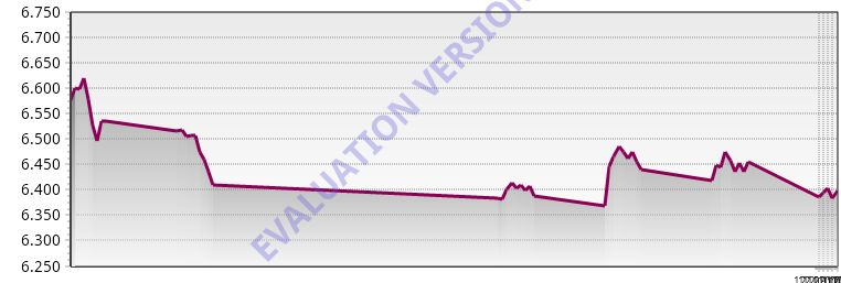

Ok i cannot send u the project but with a picture u will findout what i what to achieve
This a week chart with a Daystep as increment
But i wanna display the chart only from 9am to 6pm

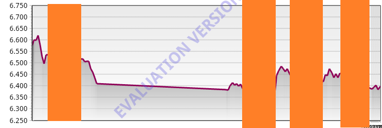

For example here:
The solution would be the chart without the orange gaps.
Any idea?

micha wrote:The solution would be the chart without the orange gaps.
Any idea?
It sound pretty much what Axis Break tool does. Please, take a look at the example at "What's new?\Welcome!\New Chart tools\Axis breaks" in the features demo included with the TeeChart Java installation (desktop version). If you only have the TeeChart Java for Android version, you can download the TeeChart Java evaluation version to see the examples the desktop version includes.

ok thanks the Axis Break tool seems to be the solution.
