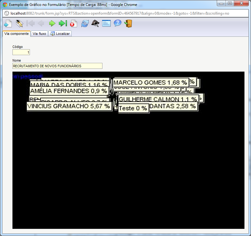

Hello there,
I'm already a customer with v1.
I'm trying to apply the V3 version to see the impacts in my systems and see if the correction's are ok. But, i'm get a black screen in my graph's and i don't know why. Basically, the only change i need to made in my graph call was the img.image() because it wait's for a Dimension class as parameter and my v1 expect int as width and height. Basically, i just put the new Dimension(w,h) into my img.image().
But i'm getting this result (see attachment bellow).
Edit: i'm sorry, i know that this is too much generic, but, i hope you guys could know what's going on.. thanks!
- Black Pie
- black_pie.png (204.84 KiB) Viewed 39803 times

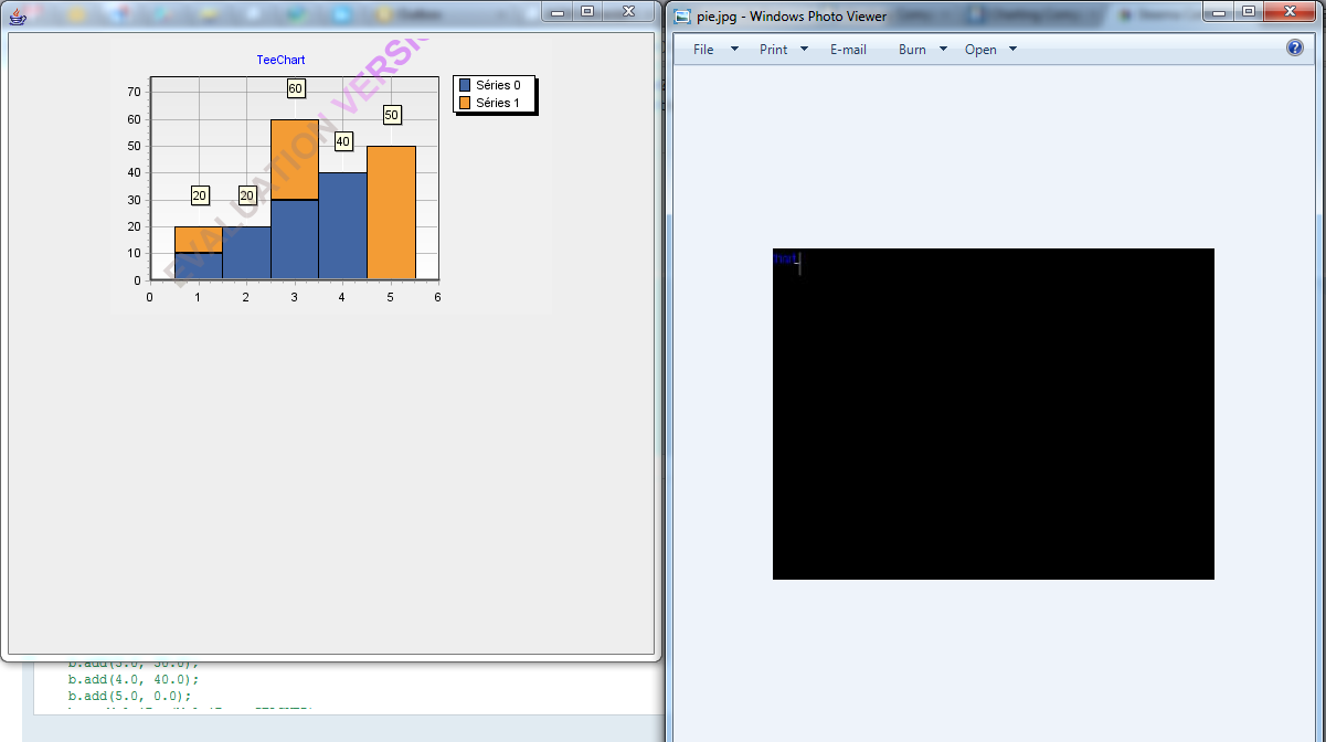

Hello again Yeray,
I got a sample code from the forum and made a little change to export the graph to .jpg
Here is the code:
When you execute the code, you get a black image form it. But it still works in the frame for example. This is the problem that i have: It works in my V1, but not in the V3 evaluation copy.
Edit1: Forget about the name "pie". I was crazy in that moment
Edit2: Perhaps there's something missing before export to file.. But i don't know what it is...
Edit3: Here is the result:

Re: Upgrade from v1 to v3-Eval
Hi Lourival,
In the meanwhile, using the chartPainted event works fine for me. You could substitute this in your code:
For this:
Yes, something like this. The problem is that the chart has to be drawn before being exported, and the getImage() function doesn't completely do it. I'm trying to find a function (update, repaint, refresh, validate,...) to force a chart repaint before the initial complete window drawing, but I can't find it.Lourival wrote:Perhaps there's something missing before export to file.. But i don't know what it is...
