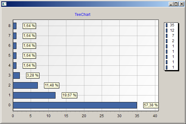

And show me this:
But the sum of the values is 61 and 35 is equivalent to 57,37%, 12 is equivalent to 19,67% ...
How can I display 57,37% in place of 57% ?

With the actual sources it has been modified and the result I get with your code is now the following:
So the next release should behave as shown.
