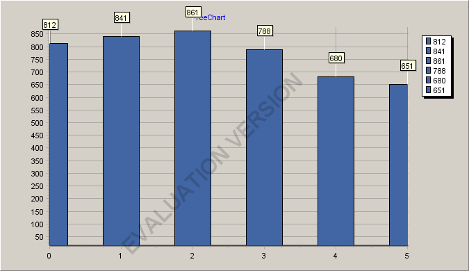

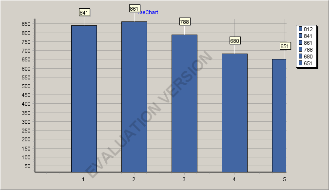

I've seen that, if you scroll a chart with a Bar series, each bar disappears when half bar is out of the bar (only in the left side of the chart). I've added it to the wish list to be enhanced in future releases (TJ71015425).
To reproduce it you only need a Bar series and scroll a little bit:
        com.steema.teechart.styles.Bar bar1 = new com.steema.teechart.styles.Bar(tChart1.getChart());
        bar1.fillSampleValues(6);
could you please confirm if this is what you are experiencing?

Hello Yeray
Yes, that's what I'm experiencing :)

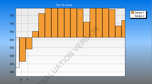

Hi Yeray, I implemented the code with another series plotted (as I have several on my project) and the result is the attachment, it doesn't work for me :( the fisrt left bar doesn't show up
Example
Sin título.png (18.75 KiB) Viewed 34281 times

Yeray, the rectangle shows up when I keep the mouse pressed down on the plot :s that's weird
