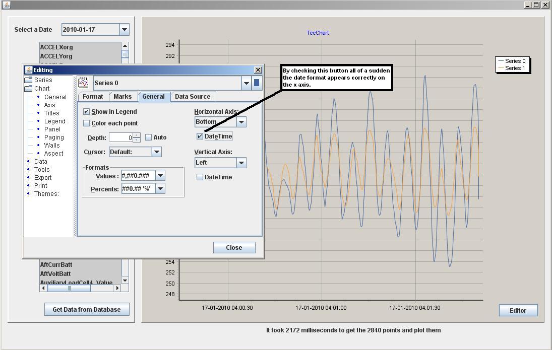

The graph displays fine but the x axis is obviously a number.
So i read the tutorial and the tried the following code with no success:
            tChart1.getAxes().getBottom().isDateTime();
            tChart1.getAxes().getBottom().getLabels().setDateTimeFormat("dd-MM-yyyy hh:mm:ss");
then i use the editor and by double clicking on one of the series and then selecting DateTime in General the problem is fixed. (Apart from the fact i need 24 hour time)

Note that isDateTime function returns a boolean. It is used to retrieve the information, not to set it.
To set it, as you've seen through the editor, you have to set the series' XValues to be DateTime. For example:
tChart1.getSeries(0).getXValues().setDateTime(true);

Perfect.
