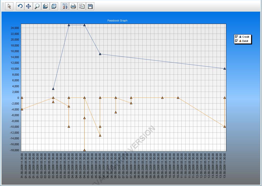

We have bought TeeChart for Java V2 recently. Please look into the attached snapshot. In the X-axis we are plotting date and time series, and Y-Axis is the amounts. "Debit" series are plotted properly, but "Credit" is completely wrong. You can see the x-axis values at each node. If I uncheck the "Debit" series, then "Credit" series will be drawn properly. But requirement is both should be viewed at a time.
We are using Series.Add(<<double>>, <<string>>) method to add points. The datetime value at X-axis are in the string value. Kindly advice us to solve the problem.

In that case you should use the add(datetime, double, string) or add(datetime, double) methods for populating series.We are using Series.Add(<<double>>, <<string>>) method to add points. The datetime value at X-axis are in the string value.

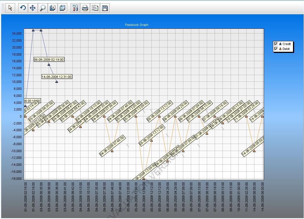

We get the datetime data from a Oracle stored procedure as "01-08-2008 02:16:00". We have used below given code to convert from datetime in the form of string to DateTime object. The datetime displayed at X-axis is still wrong. The format for the X-axis label is "dd-mm-yyyy hh.mm.ss". Kindly advise us.

Thanks for the example project. Now I understand which is the exact problem. You need to set bottom axis DateTime format as shown below, months being represented by MM as mm means minutes instead of months.
Hope this helps!
chart1.getAxes().getBottom().getLabels().setDateTimeFormat("dd-MM-yyyy hh:mm:ss");
