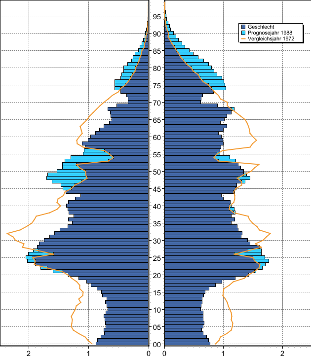

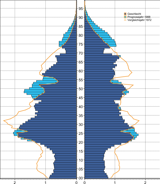

I'm using TeeChart in a Java Desktop-Applikation. There are HorizBars and a Line in the chart. The series were displayed korrect in the legend (first attachement). When I set the legend transparent, the frame of the HorizBar-Series get the Color of the Line-Series (second attachement).
Do you have any suggestions how to to solve this problem?

I could reproduce it so I've added it to the public tracker:

I've just fixed the issue.
Since you own the sources, you can apply the fix to your sources. At CustomBar.java, change the drawLegendShape method for this one:
	protected void drawLegendShape(IGraphics3D g, int valueIndex, Rectangle rect) {
		ChartPen oldPen = g.getPen();
		if (getBrush().getImage() != null)
			g.getBrush().setImage(bBrush.getImage());
		if (getPen().getVisible())
			g.setPen(getPen());
		super.drawLegendShape(g, valueIndex, rect);
			g.setPen(oldPen);

thank you for your answer. This fixed my problem.
