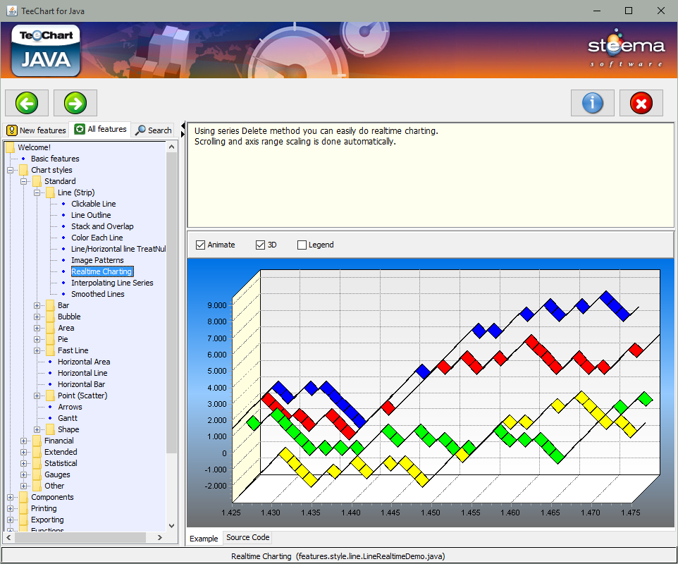

Can I with Steeama create dynamic chart per time period ? Example any speed of something in real time

Post by Yeray » Fri Feb 27, 2015 9:21 am
Hello Dimitry,
Having a series created on a chart, in this case tChart1, this code seems to work fine for me in a Swing application:
    private void setTimer() {
        ActionListener taskPerformer = new ActionListener() {
            public void actionPerformed(ActionEvent e) {
                tChart1.getSeries(0).fillSampleValues();
        new javax.swing.Timer(100, taskPerformer).start();
If you still find problems with it, could you please arrange a simple example project we can run as-is to reproduce the situation you are experiencing?

Yeray, help me realize classic speed chart
1. chart have to move left to right
2. datas must classes fifo

Post by Yeray » Fri Oct 16, 2015 3:53 pm
Hello Dimitry,
Take a look at the RealTime demo in the Swing Features Demo:
