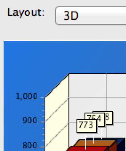

Hello.
In Mac OS font inside charts have blur fonts.
How does it fixed?
p.s.
In windows is all ok
Dmitry
Screen Shot 2014-08-05 at 12.52.44.png (17.83 KiB) Viewed 113429 times

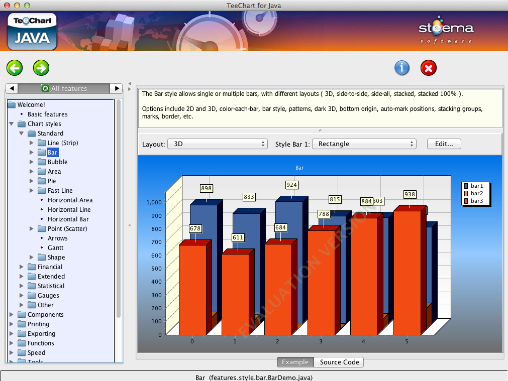

Hello Dimitry,
I've ran the Swing TeeChart.Features.jar examples in a Mac OSX and the fonts seem to look fine:
Does the demo look fine for you too?

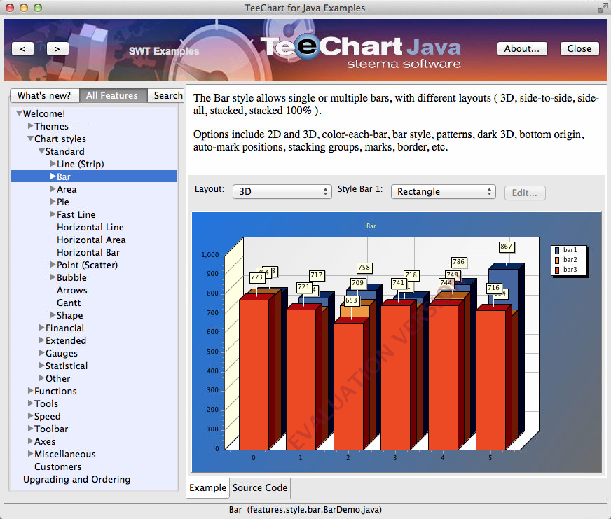

builded swt examples
too same
bluuuur

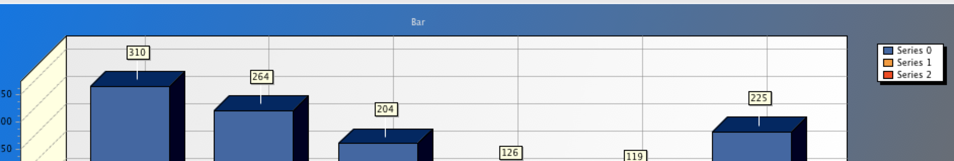

one more screenshot
Screen Shot 2014-08-06 at 23.54.45.png (182.58 KiB) Viewed 113367 times

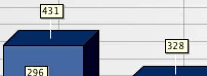

I assume you are zooming the image. Here it is what I get without zooming it:
Now, if I zoom this image a 300% I get this:
Note TeeChart texts look as blurred as the labels and other texts in the application, isn't it?
