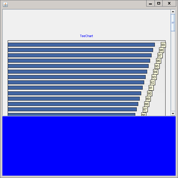

I realized an implementation, but when I scrolling, the component (TeeChart) paint wrong (out of limits).
Please help me to solve the problem.

I've pasted your exact code in a NetBeans project and this how it looks for me here:
