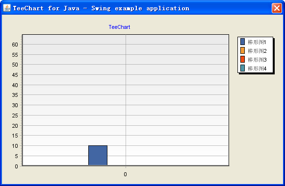

Post by rubby » Fri Aug 30, 2013 3:08 am
my code is as follows.
In the bar.png, you will find there is only one bar which is wrong.

Post by Yeray » Fri Aug 30, 2013 12:18 pm
That's a problem already present in the defect list to be fixed for further releases (TJ71016295).
I've incremented the ticket priority.

luckily, i find a perfect approach to avoid the bar problem which is very common and confuse the users always.
(Bar)chart.getSeries(i).setMultiBar(MultiBars.SIDEALL)
