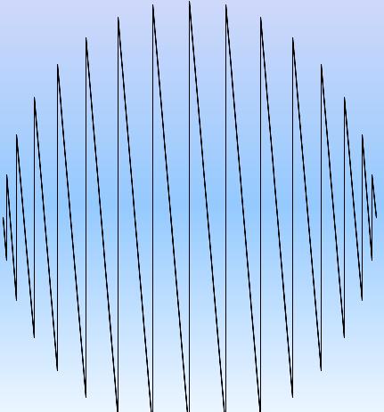

when i draw a circle by these code:
Line line3 = new Line( myChart2.getChart() );
for(i=0;i<1024;i++)
dx = 2* Math.cos( omega*dt*i + Math.PI/2 );
dy = 2* Math.cos( omega*dt*i ) ;// + 4* Math.cos(2*omega*dt*i);
line3.add( dx,dy );
i get the result:
is_not_a _circle
Re: how can i draw a ellipse,or a orbit like a irregular circle
Post by Narcís » Fri Oct 28, 2011 7:08 am
Hi lwperic,
Line series was designed to plot sequential data and hence X values are sorted ascendingly. To get a circle from this data set you should set X values not being sorted before populating series:
        line3.getXValues().setOrder(ValueListOrder.NONE);
