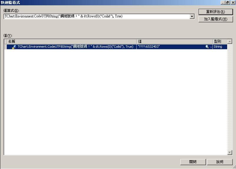

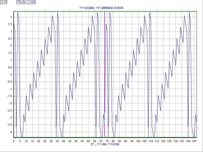

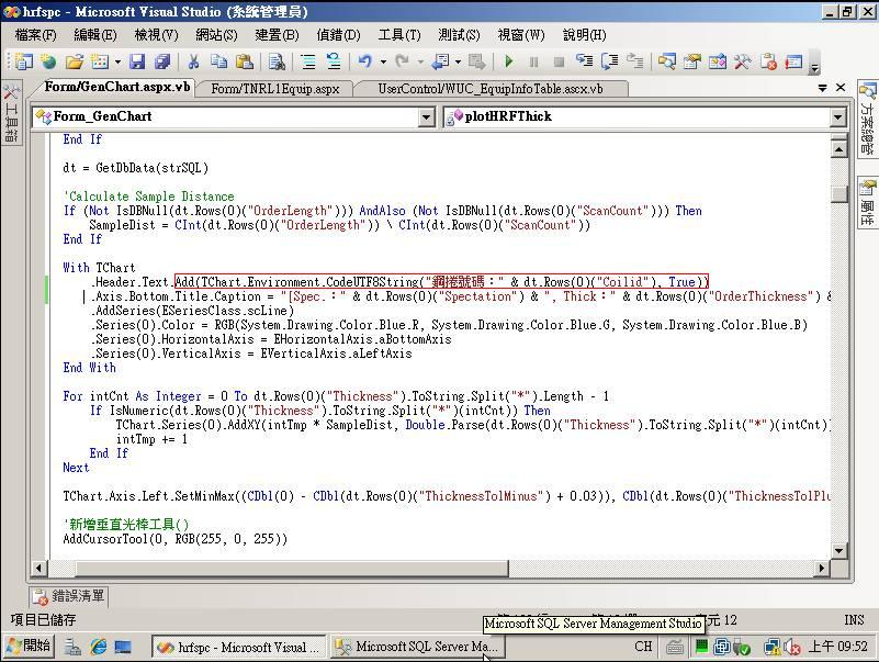

Tried the method you instructed, but the problem remains. Please refer to the attached three files for details.
1. Code.JPG is the program. 2. picture.JPG is the diagram 3. debug.JPG is the diagram after running debug.
In addition, the Server2008 edition we use is English edition, and we also use Traditional Chinese language pack as well (the language pack is released by Microsoft). Just wondering if this would have any connection with the problem?
