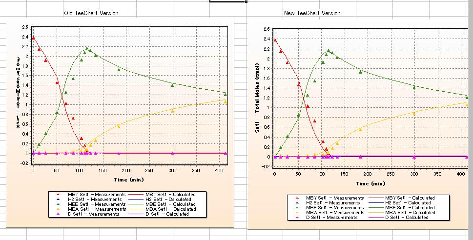

I have found another issue with the new release of the ActiveX control (v8.0.0.5 and v8.0.0.6).
When the chart is pasted into excel the text in the Y-Axis is displayed incorrectly (the attached screenshot shows the problem). This issue happens in Windows XP Japanese version. Also in v7.0.1.3 it worked correctly.
Is there a workaround to this problem?
Note: The labels in the screenshot ("New TeeChart Version" and "Old TeeChart Version") are wrong and must be swapped.

Hi OptUser,
I'm not sure to understand the problem and see it in the pictures. I see the Y axis title rotated in the picture labeled as "Old TeeChart Version" and some characters overlapping the others. Is that what you would like to achieve with the "New Teechart version" and couldn't?

I'm sorry for the delay.
I made a mistake labeling the two graphs when I pasted them in Excel, the graph labeled as "Old TeeChart Version" was actually made with the most recent version of the TeeChart control (v8.0.0.6). And the graph labeled as "New TeeChart Version" was made with the TeeChart v7.0.1.3.
Basically the graph at the left (v8.0.0.6) is not working correctly and the graph at the right (v7.0.1.3) is working ok.
What I need is to work as it was working in v7.0.1.3. Also remember that this issue doesn't happen in all Windows versions, so far we have found the issue in the japanese version.

Here is a test application to reproduce the problem. I noticed that it happens in several operating systems (including different languages such as japanese and spanish) so I believe now that the problem occurs with Excel 2000 and is not related to Unicode.
To be able to load any version of the TeeChart control the ProgId can be changed prior creating the chart control.
Once the TeeChart control is loaded it should import one of the sample charts I've exported as tee files.
The sample charts can be changed to see different charts.
You can copy the chart to the clipboard using the "Copy to Clipboard" button.
Once its in the Clipboard try pasting it to an instance of Excel 2000.
The result I have is what you can see in the left chart in the screenshot of a post above.
To be able to detect the problem I suggest first doing this test with the trial version of the TeeChart since that version has the issue. Such test must reproduce the problem.
Once reproduced, test with the release unicode version and then we can assume it's fixed if it doesn't have the issue.

Running your exe here with the latest TeeChart AX eval registered, here it is the picture given by the "Copy to Clipboard" button:
The only thing I haven't followed from the steps described for you is the Excell 2000 part. I've pasted the clipboard into an Excell 2003 and into windows Paint, both with a correct result.
It's strange. You have International Support enabled in your machines, I assume.

Yes, we already know that it works in Excel 2003. Unfortunatelly we cannot ask the client to upgrade his Office Suite just for this problem.
The issue is present in Excel 2000 but not in Excel 2003. We have the International Settings installed in the testing PCs so that's not the issue. The point is that TeeChart control that we are using (v7.0.1.3) correctly pastes into Excel 2000 when the new version does not.

We do not have Office 2000 to test here. The oldest version we have been able to run is Office 2002 on english language windows that appears to save correctly. Please could you use the Editor in your example project to save the files as an image file on the machine causing problems (or paste to Windows Paint). We can then confirm if the problem occurs independently (or not) of Office itself. As TeeChart is saving here to a static image, once saved the appearance should be the same wherever it is viewed.

Exporting as an image shouldn't give any problem since it's probably rendering the control into a bitmap. I avoid exporting as bitmap because it pixelates when its resized and when printed it looks better as a metafile.
Anyway since it doesn't happen in the 7.0.1.3 release, I bet that the metafile export algorithm was modified and texts are probably using a new feature that old metafile programs didn't support.
