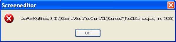

Hi Narcis,
I have another problem with OpenGL's Active property set to TRUE. This time it's when I change Regional and Lanquage Options and set Japanese language and Japan as present location on English WindowsXP. Tee Chart gives message:
"UseFontOutlines: 8 (D:\Steema\Root\TeeChartVCL\Sources7\TeeGLCanvas.pas, line 2355)".
This message appears each time when I open a dialog screen with TeeChart control or move this dialog so that TeeChart control has to be redrawn.
It never happens when OpenGL's Active property set to FALSE.

Hi Elena,
Sorry for the delayed reply. We have been doing some tests and haven't been able to reproduce the problem here. Could you please let us know the exact TeeChart version you are using and the exact steps we should follow to reproduce the issue here?

Hi Narcís
I'm using TeeChart7.ocx version 7.0.1.3. The project C++ preprocessor options include _UNICODE;UNICODE. I have WindowsXP Professional (Service Pack 3) installed on my PC.
When I select Start menu -> Settings -> Control Panel -> Regional and Language Options. On "Regional and Language Options" tab I select Japanese language in "Standards and formats" and Japan in "Location". Click OK. Run any application that shows 3D Surface graph with . I use the following initialization:
CTChart m_3DHistory;
CAspect m_3DAspect = m_3DHistory.GetAspect();
CSeries m_3DSeries = m_3DHistory.Series(2);
CSurfaceSeries m_3DSurface = m_3DSeries.GetAsSurface();
m_3DHistory.GetCanvas().SetUseBuffer(TRUE);
m_3DHistory.GetPanel().SetBorderStyle(bsNone);
m_3DHistory.GetPanel().SetBevelInner(bvNone);
m_3DHistory.GetPanel().SetBevelOuter(bvNone);
m_3DAspect.GetOpenGL().SetActive(TRUE); // Make surface colors smooth
m_3DAspect.GetOpenGL().SetAmbientLight(0);
m_3DAspect.SetChart3DPercent(100);
m_3DHistory.GetZoom().SetEnable(FALSE);
m_3DSurface.SetIrregularGrid(TRUE);
m_3DSurface.SetUseColorRange(FALSE);
m_3DSurface.SetUsePalette(TRUE);
m_3DSurface.SetPaletteSteps(COLOR_LEVELS);
As you can see I set: m_3DAspect.GetOpenGL().SetActive(TRUE) to make surface colors smooth. This is when the message that I described in the original question appears. If I set GetOpenGL().SetActive to FALSE this message never appears.

Hi Elena,
Thank you for the information. I've been able to reproduce the problem here so I've added it to the defect list to be fixed in future releases (TA05014697).

It looks like the problem is resolved. We noticed that not all our customers with Japanese language have this problem. We compare their settings and found that there is one more setting in ”Regional and Language options” screen. On “Advanced” tab there is setting “Language for non-Unicode programs”. If “Japanese“ is selected there, 3D works even with active OpenGL (SetOpenGL().SetActive(TRUE)).
Thank you kindly for looking into this matter for us, however we’ve been able to find the solution.
Best regards
Elena

Hi Elena,
Thank you for sharing the solution, it will probably help other users with similar problems.
In Win7, the “Language for non-Unicode programs” option is under "Region and Language" screen, "Administrative" tab.
